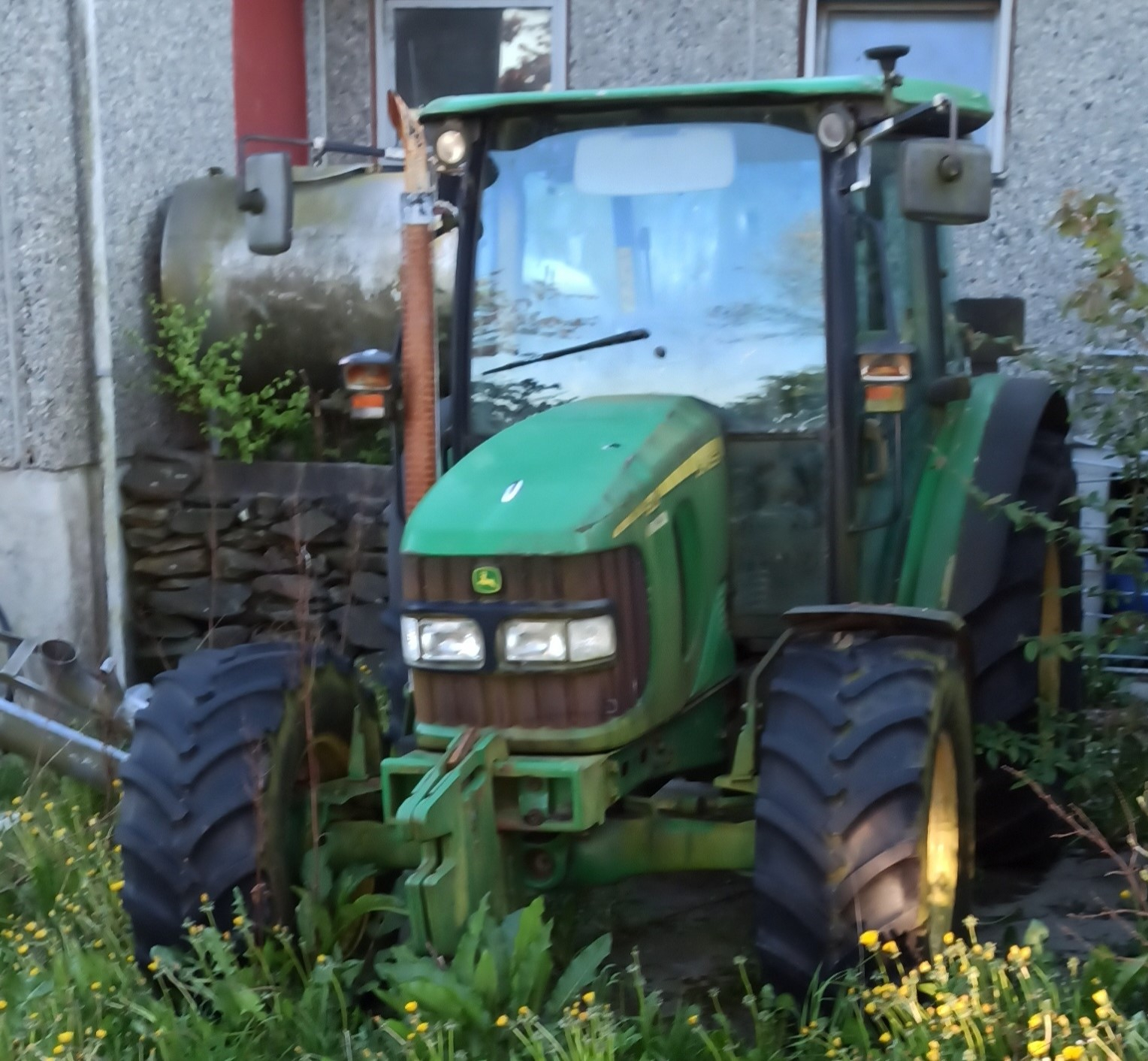

My uncle became ill about 2 years ago and as a result his farm was pretty much abandoned since then. We are now trying to repair his John Deere 5820 which was parked outside for 2 years. Tractor was working fine 2 years ago.
We would like to get the tractor operational, it wont ignite currently. We have installed new battery, refilled oil, drained water from the system.
What should we do next? Dismantle the injectors maybe? Drain the diesel and refill? (Tank is half full)

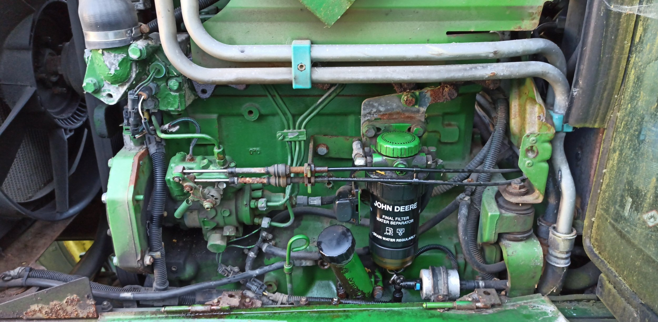

I was actually able to ignite 1 time, but it died after about 2 seconds. The 20 attempts before and 20 attempts after was unsuccesful.
Any help is appreciated!

It could be fuel gone bad from sitting and from moisture clogging fuel filter(s) or lines. Even bacteria that grows in fuel. So maybe drain the fuel lines and put in fresh fuel.
Next could be air in fuel lines from many cycles of air pressure/weather changes. Loosen each injector fuel line at the cylinder head about 1 or 2 turns and engage the starter. You want to see fuel squirting from each. Not air bubbles. When and if bubbles have stopped, tighten the injector lines 1 at a time. It may fire as you close each line and begin to fire and run rough.
Exhaust smoke from burned fuel is black. If white smoke, there is not enough compression to ignite the fuel. From either dry cylinders (oil has left the area) or from insufficient starting speed (battery voltage and/or poor battery cable connection(s) due to corrosion.
If you can move it, I often get them started and running by pushing the tractor on a roadway in first gear to get the engine spinning much faster than the starter can get done. If the fuel is good, and the oil gets back into the piston rings, the compression will certainly become high enough to make it start and run.
If you get it running, let us know what it took to do so. It helps maybe the next person with same trouble !

Got it up and running today! :cool:(y)
@zzvyb6:
On the money! We drained the battery twice getting the air out though, Isnt there a better way? BTW, we did use starting aid fluid the first time it started.
We also drained&refilled diesel. Next on the list is:
