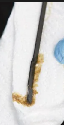

Since you say the oil is not even hitting the bottom of the dipstick, my bet is the oil is so clean you cannot easily see the level on the dipstick. Clean oil is hard to see on a dipstick.
Take a clean paper towel and lay the dipstick on it. If the oil is clean enough it is hard to see on the dipstick, the dampness from the oil on the paper towel will show you the level of oil.
I have always believe that 1. Go by the dipstick to find the correct amount of oil. 2. Whatever you do, do not overfill the oil.
