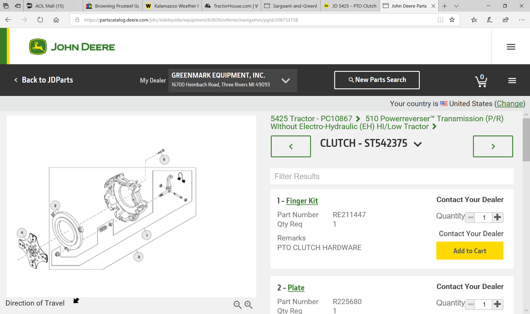

   / JD 5425 - PTO Clutch Lever Linkage #4
It sounds like the pressure plate or fingers are stuck, not allowing the springs to put pressure on the plate and clamp the PTO clutch disc. Or the PTO clutch is worn too thin.
Is there any inspection port?
I just found it this thread I had posted and wanted to say thanks for the responses.
What ultimately happened is my PTO went out... u couldn't even manually engage.
The my clutch clutch went out.
I know then it needed to split. Finally located a mechanic and all good. Said once split .... He didn't understand how I ever drove tractor. Some bushings that are exposed on side of engine/trans housing were totally rusted and froze up along with the rods they connect with. He said he spent more time cleaning that mess up than he did splitting changing clutch which was pretty easy.
When I asked how worn the clutch was he said "I don't know" . I asked what do u mean. He said, "I couldn't tell because they were so rusted" .
So basically, this tractor must have taken some water/flood and I was dealing with the residual problems. I bought the tractor about 2 yrs ago. It worked fine for about 1+ years.
Anyway.... All seems good now. We'll see. Thanks again!!
