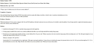

Well, I have two out of three wishes come true today. The JD tech installed an inline electric fuel pump and a electric fuel filter bowl heater on my tractor. Both are required as the electric fuel heater is placed into the top of the filter where the hand prime pump once was. This will hopefully eliminate the loss of prime due to improperly functioning check valves and any chance of fuel gelling.
No more gelling like a felon. I am a happy man.

Your darn right it will help, but so many things in the "corrective" measures do not seem to fit my tractor. It mentions check valves in the line from the tank to the filter. Mine has none. I replaced the supply and return lines yesterday, and from the tank to the filter was one 3/8' line with nothing else. The return line was one piece of 1/4' from behind the muffler to the tank. Where are the unidirectional valves? Where is the strainer? Are they referring to the filter? Is there anything in the tank?
I am positive my "primer pump" is, and has been junk since I bought this tractor new.. I want to replace it with an inline fuel pump. I talked to the local dealer yesterday about the problem, and he made no mention of a "fix." I'll try a different dealer tomorrow now that I'm armed with this info.
The only way I have ever been successful in repriming my system is to pressurize the tank and open the supply line at the injector pump.
MANY thanks for your input.
Tom
   / JD 5420 Fuel Filter - Wish List #9
The electric fuel pump retro fit will solve the (automatic) purge problem by pushing air out of the system and back to the tank via the return lines.
I don't see anything from Deere that addresses the heated filter issue.
The in-line strainer is:RE220719
The check valve is:AL117189

I have ordered the fuel pump, and by Tuesday, I should be out of my misery. All this because you spoon fed me the info I needed.
