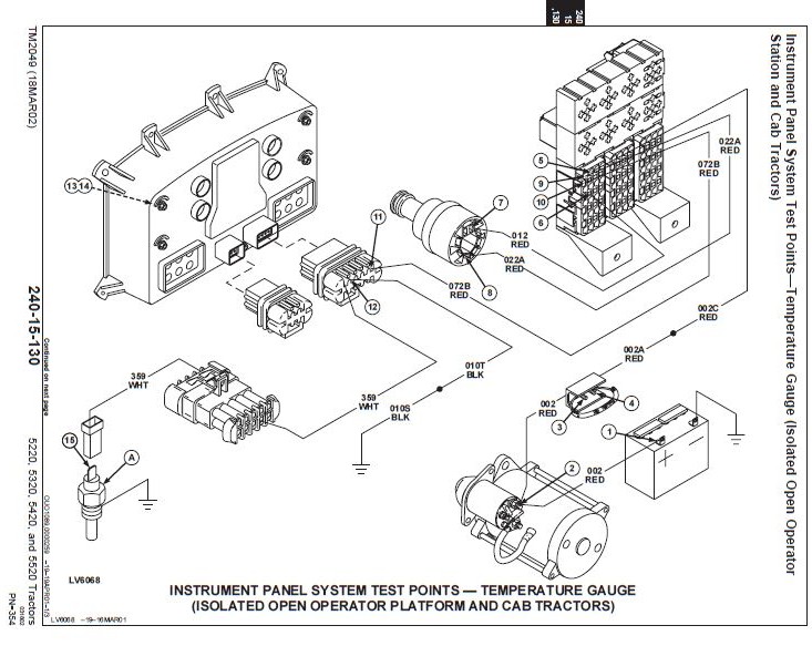

I had a chance to diagnose the problem today with the tractor sitting cold. The problem is clearly the temperature sender (thermistor). The temperature sender on the Powertech 2.9L Diesel engine is located on the top-left-rear side of the engine block as show in this picture.

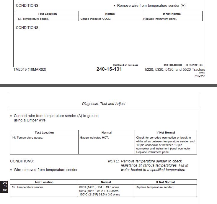

To test if the temperature gauge is bad you unplug the white wire from the temperature sender while the key is in the run position. If the temperature gauge shows "cold" (needle sitting to the far left on the stop) then this indicates the temperature gauge is working normally. Next, you short the white wire to ground. Again, with the key in the run position. The instrument gauge should show "hot" (needle sitting to the far right on the stop). This tells you the temperature gauge is working normally. By process of elimination the culprit is the temperature sender.
To verify that the temperature sender is, in fact, bad you remove the temperature sender then measure the resistance of the sender in different temperature water as shown in the chart below.
The part number for the temperature sender is RE51774. The cost is approximately $35.
