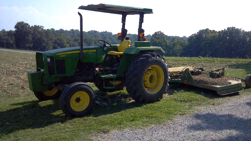

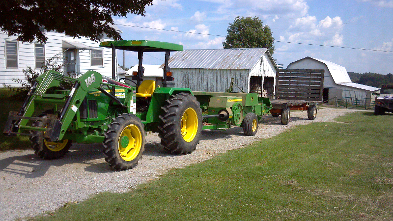

Like the pics!
How wide is the pull type mower? Any issues pulling it in tall grass?
   / JD 5303 Range Shift Lever #9
The 472 haybine is 7ft., the disk mower is 8 ft. No problem with power on either 5403. I've pulled the haybine with the 5203 as well.
