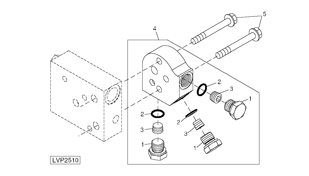

I'm not familiar with the hyd system on a 5205 but this PB end cap is available from JD.
RE73581 HOUSING, VALVE, POWER BEYOND ADD 87.26 USD
And this is available if you can stand the price.
RE71787 VALVE, POWER BEYOND ADD 2,561.06 USD 2,561.06 USD

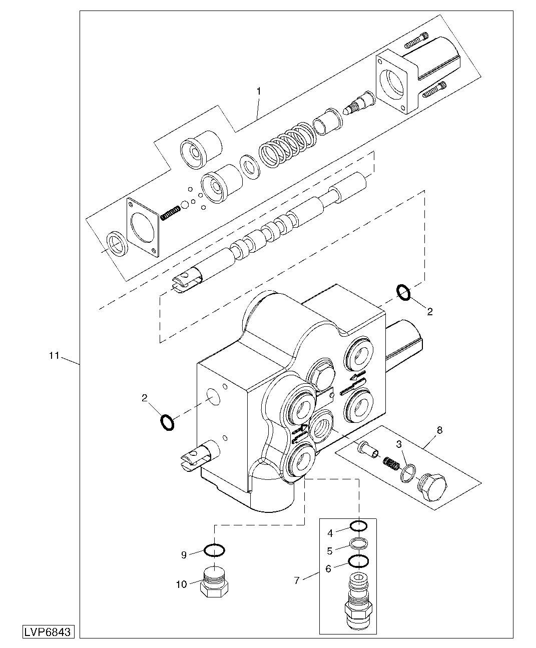

There will be a PB port, either as Tx Jim stated, or you can use the PB port from the loader valve, and run a PB hose with a male QD to the back for the BH.
If there are three hoses from the BH,
Plug the female QD IN hose from BH to the rear male QD hose from loader.
Run the OUT hose from the BH to reservoir.
If your valve has PB, then run a hose from the BH PB port to the input for the 3pt.
If you remove the BH, then connect the PB hose to the 3pt input hose.
If you can find the JD adapter for the PB, the ports should be self explanatory.
PB output from tractor
PB pressure hose from BH for 3pt series flow, not that you will use the 3pt with BH mounted.
OUT port for BH return fluid.
Should you remove the BH using the JD adapter, you would run a jumper hose from the adapter PB out to the other adapter PB port, and plug the adapter return port.
   / JD 5205 Power Beyond Kit #6
Here's a parts photo of the PB(parts key #7) that J_J referred to on loader control valve.
