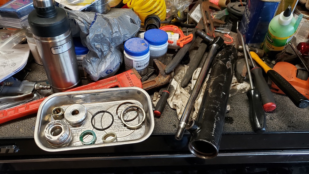

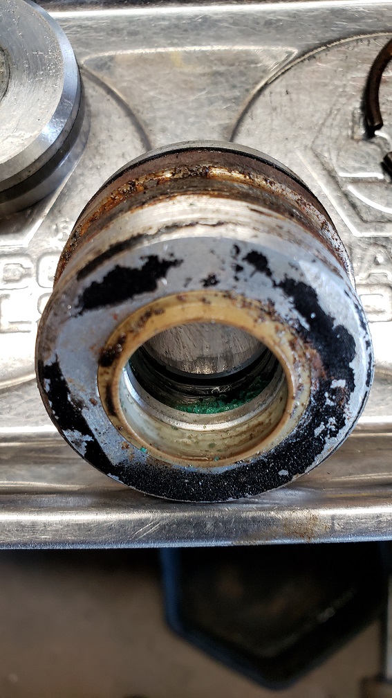

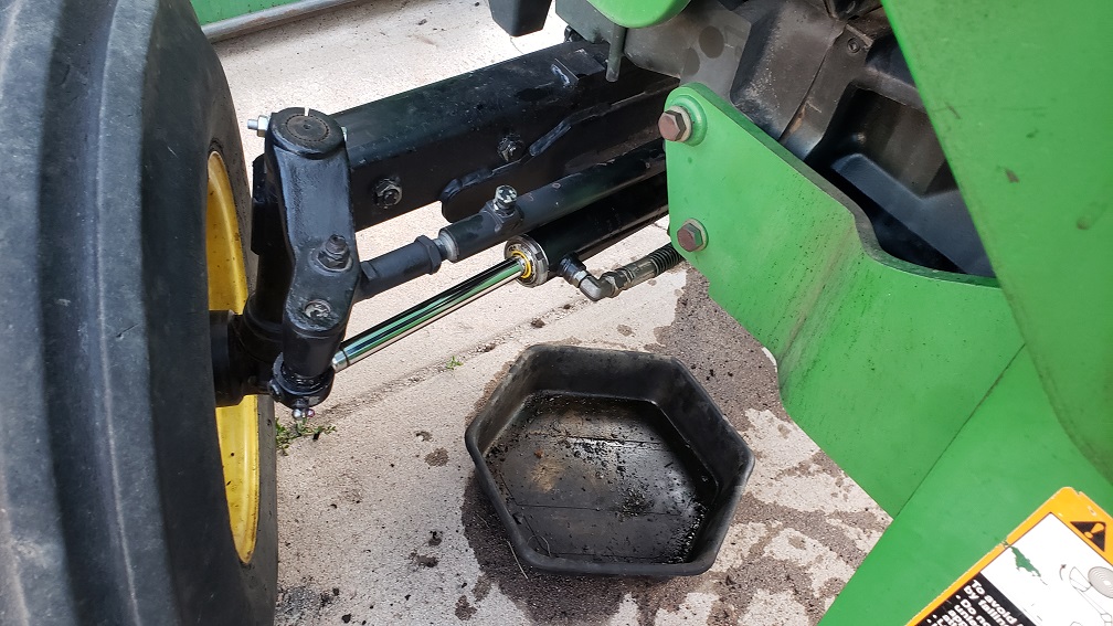

The steering cylinder on my tractor was dripping fluid past the polish rod, so I ordered the repair kit and completed it today. Taking the cylinder apart wasn't too bad, but getting the new seals in place was a pain. It's not leaking anymore and hopefully it will stay that way. In the one picture, you can see that the teal seal is degraded, which caused the leaks. I also change oil/filter, trans filter and fuel filter.
