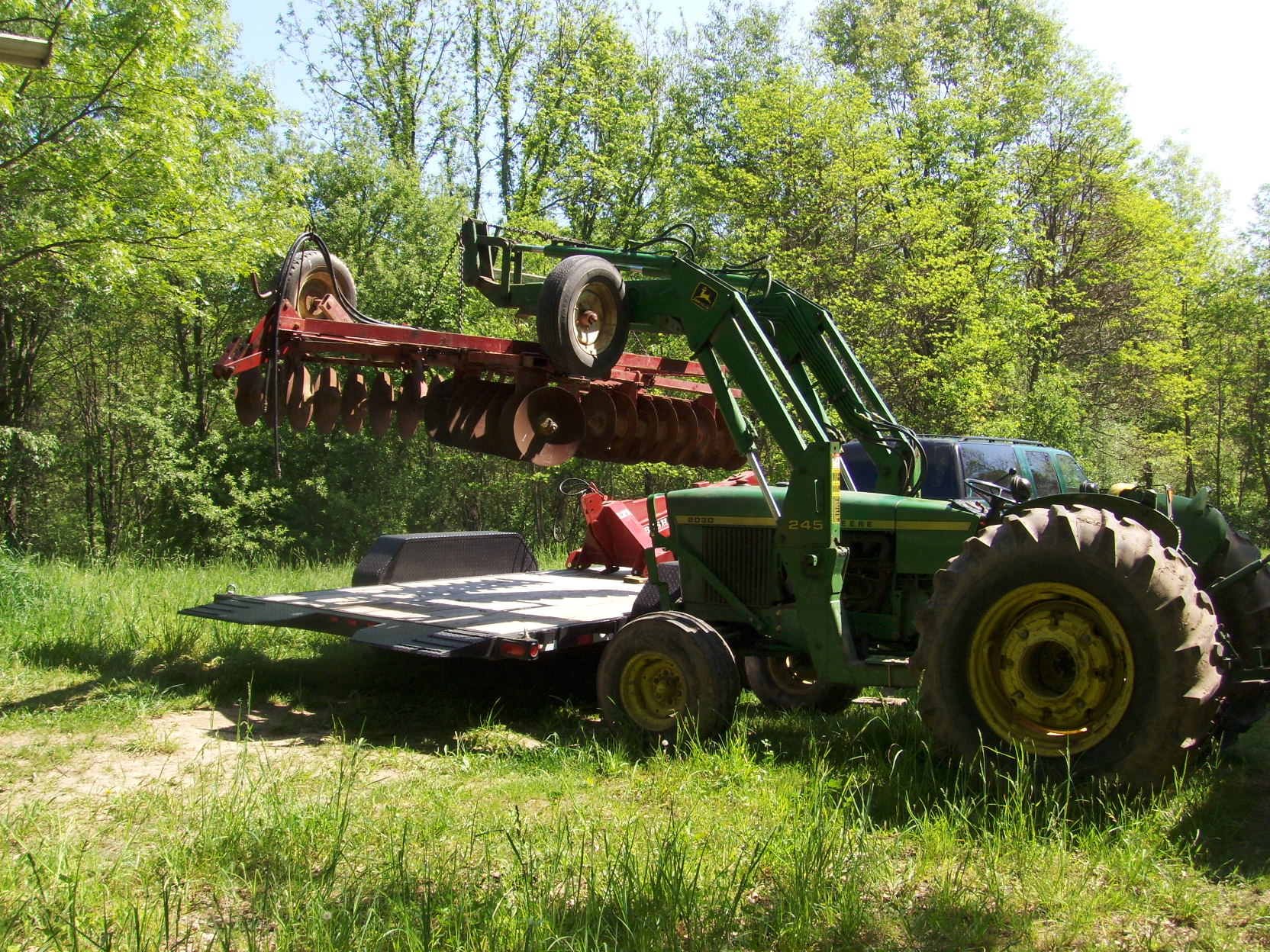

Pictured 2030 has two 110lb wheel weights per side, loaded tires (wish they were not calcium chloride), and I have to use rear ballast on the 3pt hitch to use the full capacity of the loader.

3- I have one weight on each side and loaded tires and still need at a minimum my boxblade or at best my 2400# counterwieght to feel comfortable lifting a full bucket above the cab.
