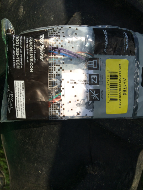

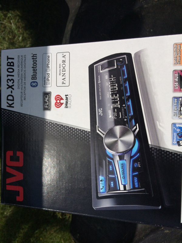

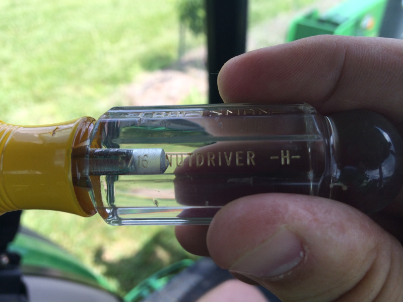

I had planned to use today to install a radio in my 5083e. Not only would it be nice to have music, but it would be very handy to have Bluetooth hands free calling to my phone. With my job I'm tied to my phone. I've run into a hurdle, but I'm persistent and will see this through to the end. But I need help. So this is the radio I planned to install. image-89384406.jpg This is the adapter I thought I needed. image-276423550.jpg This is the crimp connectors I plan to use. image-1500372972.jpg This is he view inside the cab of the radio location. image-3082635216.jpg It takes a 5/16 nut driver to remove the cover. image-3761961117.jpg The cover comes off easily and there's three things that fall out: the radio connector, the antenna, and some other connector with three wires. image-3130318326.jpg image-2193184059.jpg So my dilemma is that the wire colors don't seem to make sense. For instance, the yellow and green come out of the connector and goes into the right speaker. I forgot my multimeter so I wasn't able I so any testing for ground, hot, and switched. Those should be easy but I can't imagine where to begin on speaker wire identification. I've used these threads for help, among others on TBN. http://www.tractorbynet.com/forums/...250699-3720-cab-tractor-satelite-install.html http://www.tractorbynet.com/forums/...ing/111330-radio-installation-jd5220-cab.html There's really not a comprehensive thread on this that I could find, but with help I'd gladly make this one as pictorial and user friendly as I can.

We put a JVC in our 5065M and I suspect the connections are the same. You need this wiring harness it's for an older VW, have know idea why JD chose an connector from the 80's, they probably figured no would go tot he trouble to figure out which one it needed and would pay them $600-800 for their radio:
Access Denied
Amazon is much cheaper but I don't know for sure if it's the correct one. We picked up 2 different harnesses at BB and took back the one that didn't fit the JD connector. Once you get it all wired up run a ground wire from the radio chassis to a good ground or it probably won't work until you do so.

Yes I have the harness you describe already. It mates fine to the Deere connector. That's what's in the second pic of my original post. It just doesn't make sense with the wire colors not matching up.
   / JD 5083e Radio Install with Pics - need help

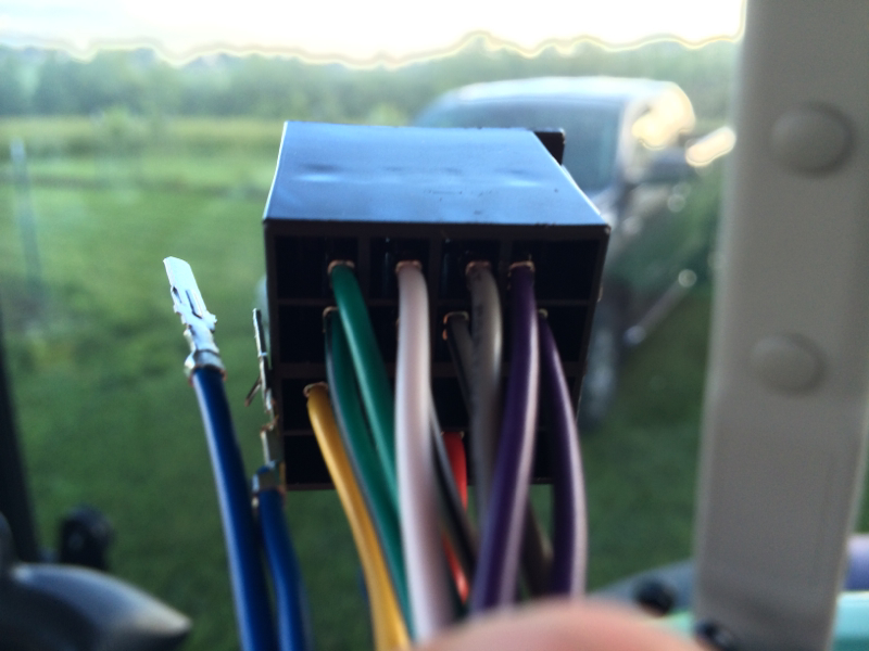

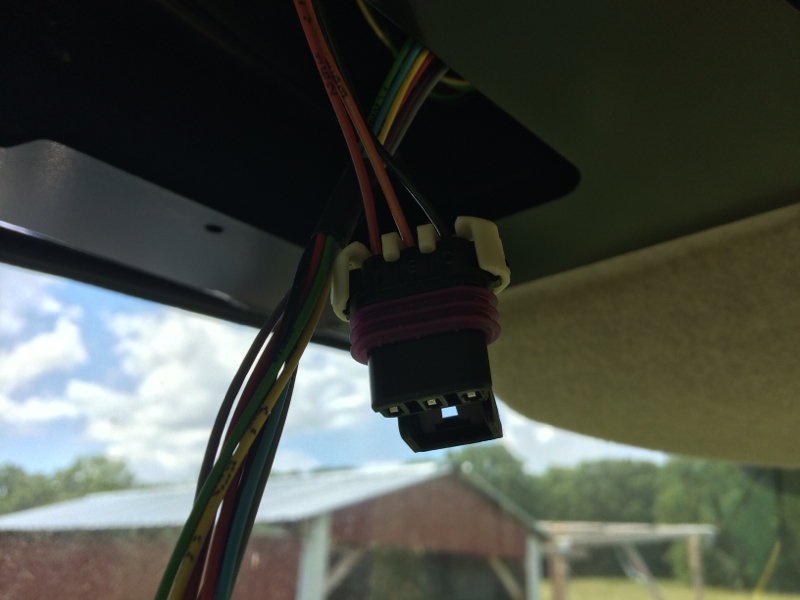

I figure some close ups are in order. The first two pics are of the harness made by metra. It's model number 70-1784. It says "Audi 88-99/Volkswagen 80-2011. Despite the wire colors, it mates perfectly with the Deere connector. For some reason blue and blue/white were disconnected.
The next two pics are of the connector inside the tractor. According to my multimeter, none of the wires is a ground. The red wire toward the middle adjacent to the black is 12v. The double red in the same row as the black is switched 12v with the ignition. The yellow and green go up to the right speaker, which makes me think the blue and purple next to them go to the left speaker.

Thanks again dishpointer. The schematics that pclausen posted in the thread linked above for a 5085m illustrate what I'm seeing in my 5083e. One thing I don't understand from the schematics is which wires are positive vs negative to the speakers. Sorry to be dense maybe it's on the schematic I'm just not seeing it.
