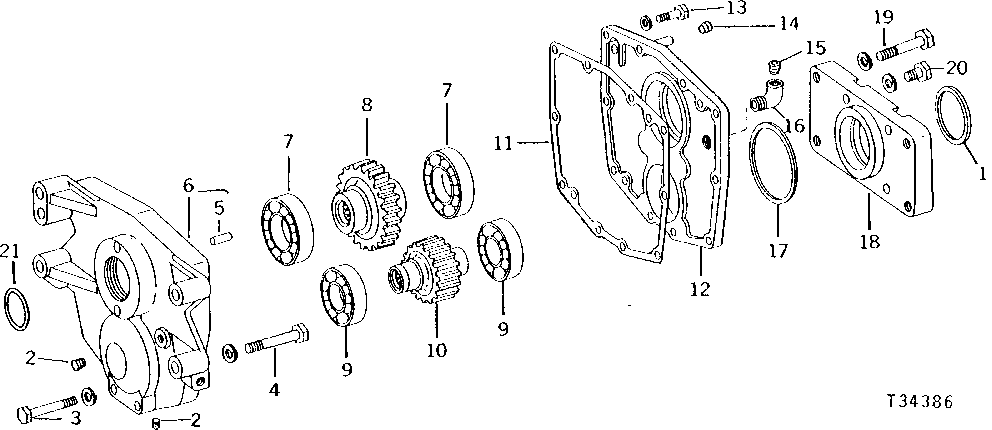

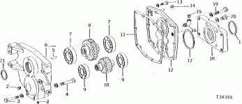

TxJim. JD parts shows a mid mount hydraulic pump that is not the trans pump. I think you two are talking about two different pumps

What heading are you finding that schematic or could you post a part number listed on the page? My industrial knowledge is very limited but I don't find this page listed under hyd pump in index in PC 1128. 500B and Ag tractor 3020 are similar models
   / JD 500B Industrial backhoe loader Hydro Pump question. #9
Zebrafive
The pump looks like a front mounted pump. The drawing I posted is the mount/drive for the pump.
PC 1128 > Sectional Index > 75 Mid-mounted hydraulic pump, drive, filter. and hoses > 2 Mid-mounted hydraulic pump drive
P/N key 8 is R34315 Pinion

I am referring to the external Mid Mount pump as ZebraFive is showing in the diagram.
