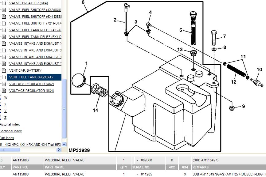

The Gator parts show a Pressure Relief Valve, part no. AM115608
Part #10 in pic and listed as "Vent, fuel tank"
Is this possibly the culprit? I suspect since the fill cap is just below the seat that they don't want any gas fumes coming out there. I'm not sure how the pressure relief valve would cause your problem, but it is in the fuel line.

Thanks. I found the vent and it hides in the arm tube for the seat on this gator.
