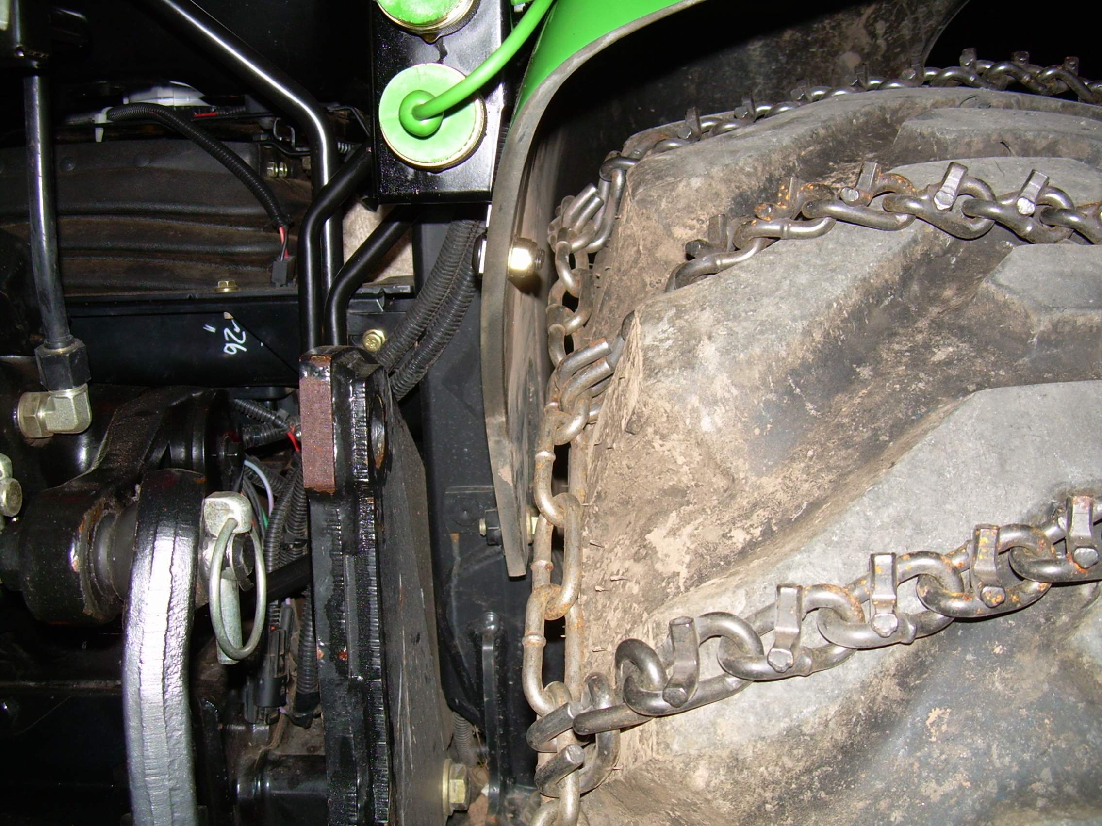

I have a 48 but don't know what plate you are referring to?
If it's the main mounting plates that stays on the tractor, I did not know there were 2 sizes, maybe for dif size tractors, if so I doubt there would be any way to interchange without some serious modding.
What tractor are you trying to put it on? I have a 4310

I'm referring to the plate that is on the backhoe. The black framework that the seat attaches to. This connects to the side plates .The side plate like the one you show in the picture are specific for the model tractor. You have the medium size frame tractor. I need the same size as yours. I have a 3320.

I purchased a 48 backhoe on ebay a few years ago. It came with the bracket for the large frame tractor.
I have it mounted on a 4310. I purchased the two plates that bolt to the tractor itself from Deere. They told me at the time that I would either need to replace the bracket, which is part of the backhoe, with the AM127743 bracket for medium frame tractors, or modify the bracket myself.
As it turned out, the hoe with large frame bracket does fit onto the 4310. The spacing is the same where it attaches. Judging from the pictures on jdparts, this setup puts the hoe several inches lower and rearward of where it would be. And the feature where you lift the hoe into place with the rockshaft arms doesn't work because the spacing of the hooks at the top of the bracket is different.
I've been using it like this. Like you, I'm thinking of either finding someone to trade it for the medium frame, or modifying the bracket. That rockshaft feature would be nice.
