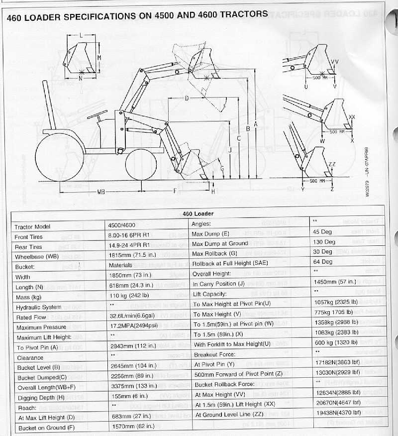

I'd love to take the JD 4710 seriously, but can't for a few simple reasons at this point.
1) I can't find specs on the loader either on their web site or in the literature the dealer gave me (where he said I could find the specs). Without this, I can't compare it to the Kubota.
2) Ditto for the JD backhoe.
3) The JD doesn't offer a cab. Hopefully some day they will, but nothing right now.
I realize all these things can be overcome in one way or another, especially the specs, but I just can't find them and am not going to go way out of my way to get basic information about a tractor. For $25k-$30k I should be getting spoon fed everything I want to know.
It's too bad, because I'd like to give it serious consideration. In Vermont, where I'm getting all my seat time, the JDs are way more prevalent and the dealers are closer by. However, right now I either can't compare, or it doesn't compare.
   / JD 4710 vs K L4610 #6
I have all the specs for the JD 460 loader, one big difference between it and the LA852 is the physical weight. The JD460 weighs 840lbs while the Kubota LA852 weighs 1213 lbs. Lift capacity at pivot pin to max. height is JD 460 2325 lbs, LA852 2470lbs, there are many more figures available as well. Rat...
   / JD 4710 vs K L4610 #7
Where did you find the specs?
   / JD 4710 vs K L4610 #8
Here is the full spec sheet for the JD460 loader from my owners manual.
   / JD 4710 vs K L4610 #9
thanks
