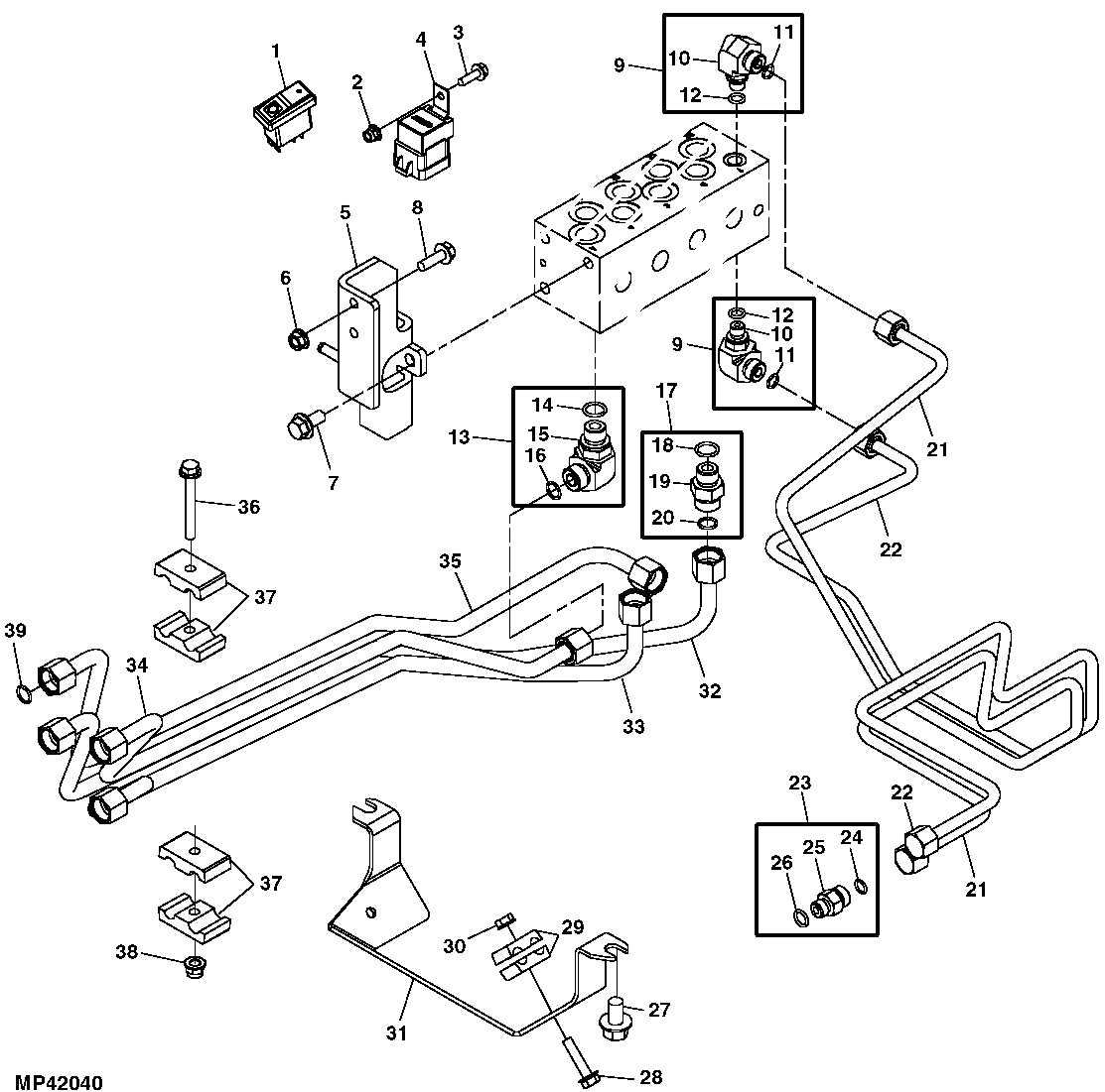

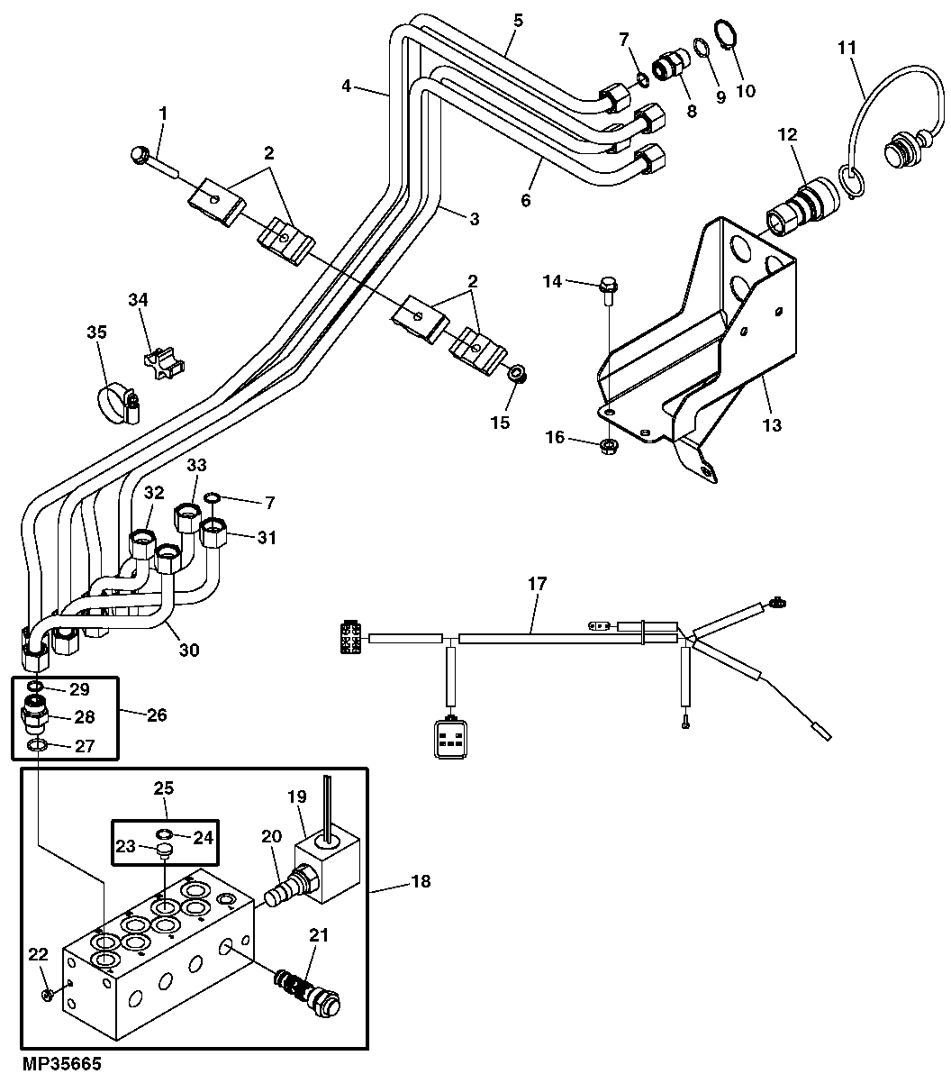

   / JD 4610 strange hyd problem #5
OK, I got it...I forgot about the electric diverter setup they had, and called it the 4th and 5th SCV kit. Sold for about $1200 or so...
Here is my theory:
The diverter is operated by solenoids, and I suspect one of two things is happening,
1) The electrical connections that run the solenoid block could be a little dirty and causing a voltage drop and thus the diverter cannot operate. You could disconnect all the connections (relay, switch, ect) to make sure they are clean and apply some die-electric grease to them.
2) The internal spools of the diverter are slightly corroded and are not sliding in the bore easily.
One question, does the light go out or stay on when this happens?

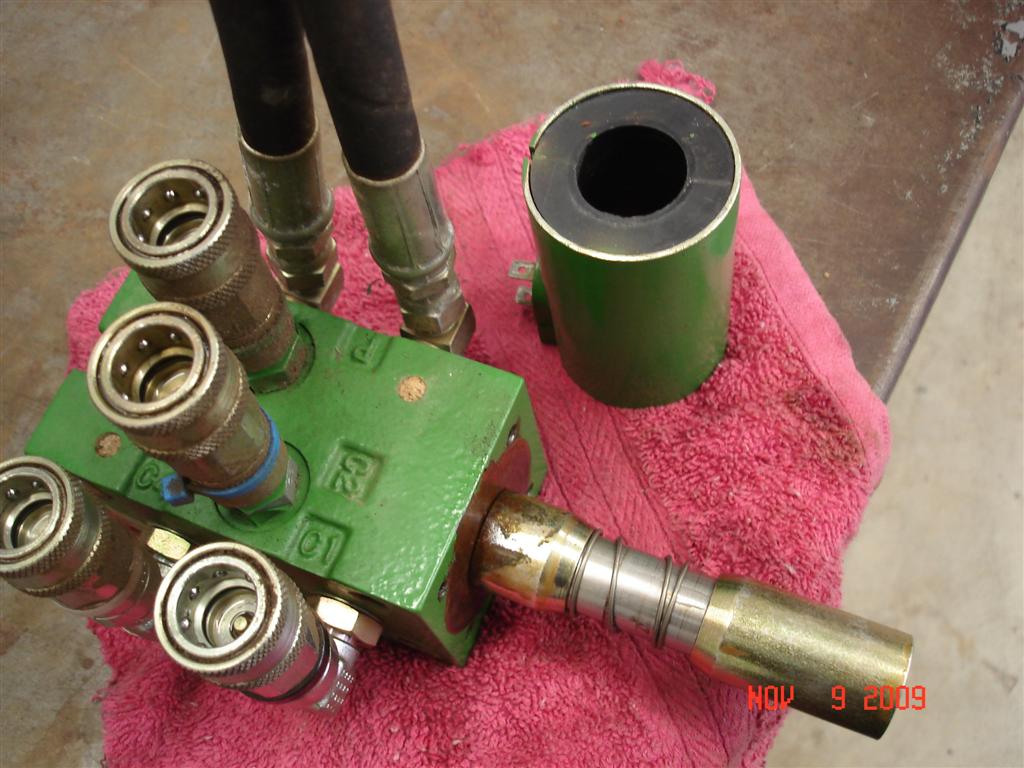

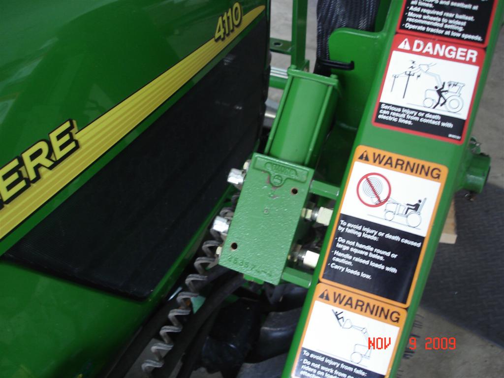

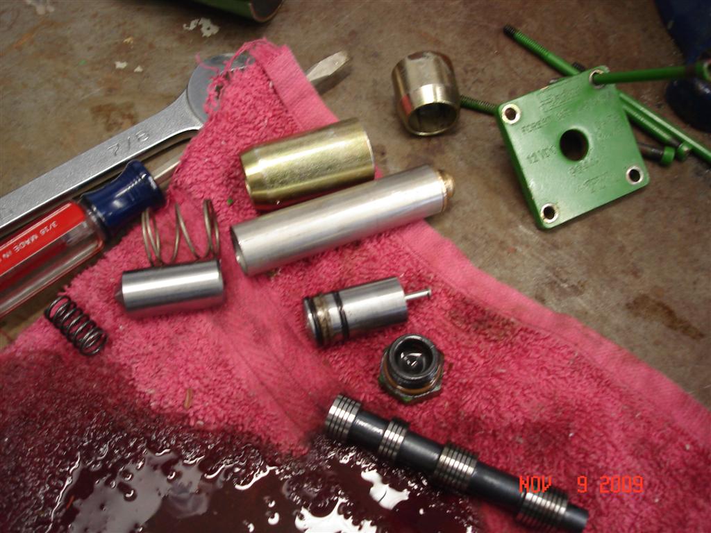

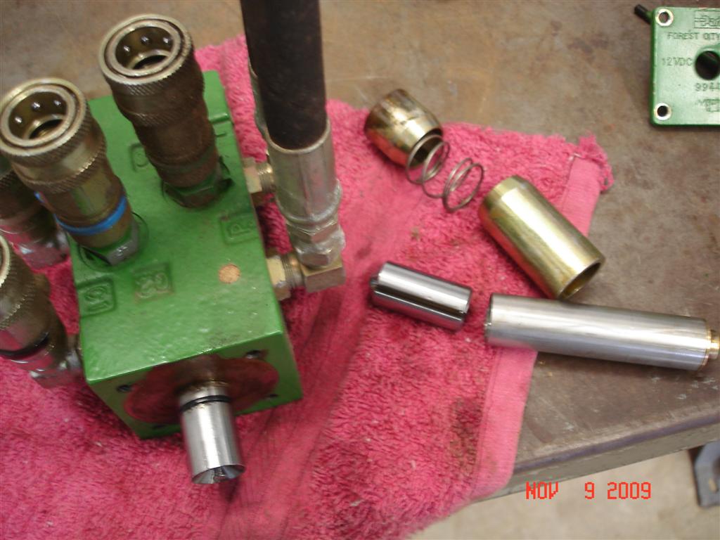

I just remembered I have some pictures of my diverter that I had to rebuild for a simular reason, it would not push the spool to divert at all. I found corrosion on it when I took it apart.
#9
Kenny, I will take that valve apart as this sounds like a likely problem. thank you for the pictures. They tell story. It may be a while before I get time to rip into it, but I will let you know what the outcome is.
Thanks again.
Troy
