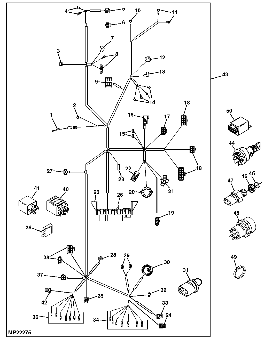

Battery tests strong. Transmission is shift, not hydrostatic. I'll try isolating the neutral switch on forward reverse lever. Can find wiring diagram anywhere. JD makes it hard to fix without such support. Thanks for the advice guys.
   / JD 4600 won't start solenoid and termister replaced #6
parts schematics don't help much but terminal #27 states for trans & parts key 47 is NS switch. If engine turns over I think NS switch is OK. I think that the problem is associated with fuel control solenoid or it's electrical source.

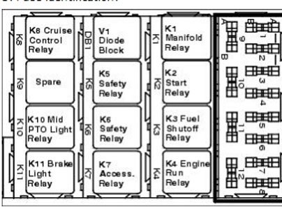

Turns out it was a bad diode and possibly one bad relay. I replaced the run relay and the V1 diode. I had no way to check either, other than check continuity between closed parts of the circuits. By swapping the K2 start and the K4 run relays with others that are less likely to be the problem, such as K7 Accessory Relay, I narrowed down the one that would create the problem, which was the intermittent failure of the stop solenoid. Turned out to be the run relay. I'm not certain how they are interconnected but you seem to need a complete set of K2, K3 and K4 relays for proper start and run operations. I had nothing to swap with the V1 diode and it costs about $15 so I replaced it. The relay costs about $20. A new stop solenoid cost $250!! I've attached a drawing of the relay layout, which I found on line after a long search. The JD dealer service manager was a help but mostly a a sounding board. Like most modern mechanics they tend to just install new pieces until the thing works, not knowing exactly how the circuitry is mapped. I think a diode or relay failure would be rare, but if you have replaced or determined that the solenoid and thermistor and battery and starter are good I would suspect the relays.
