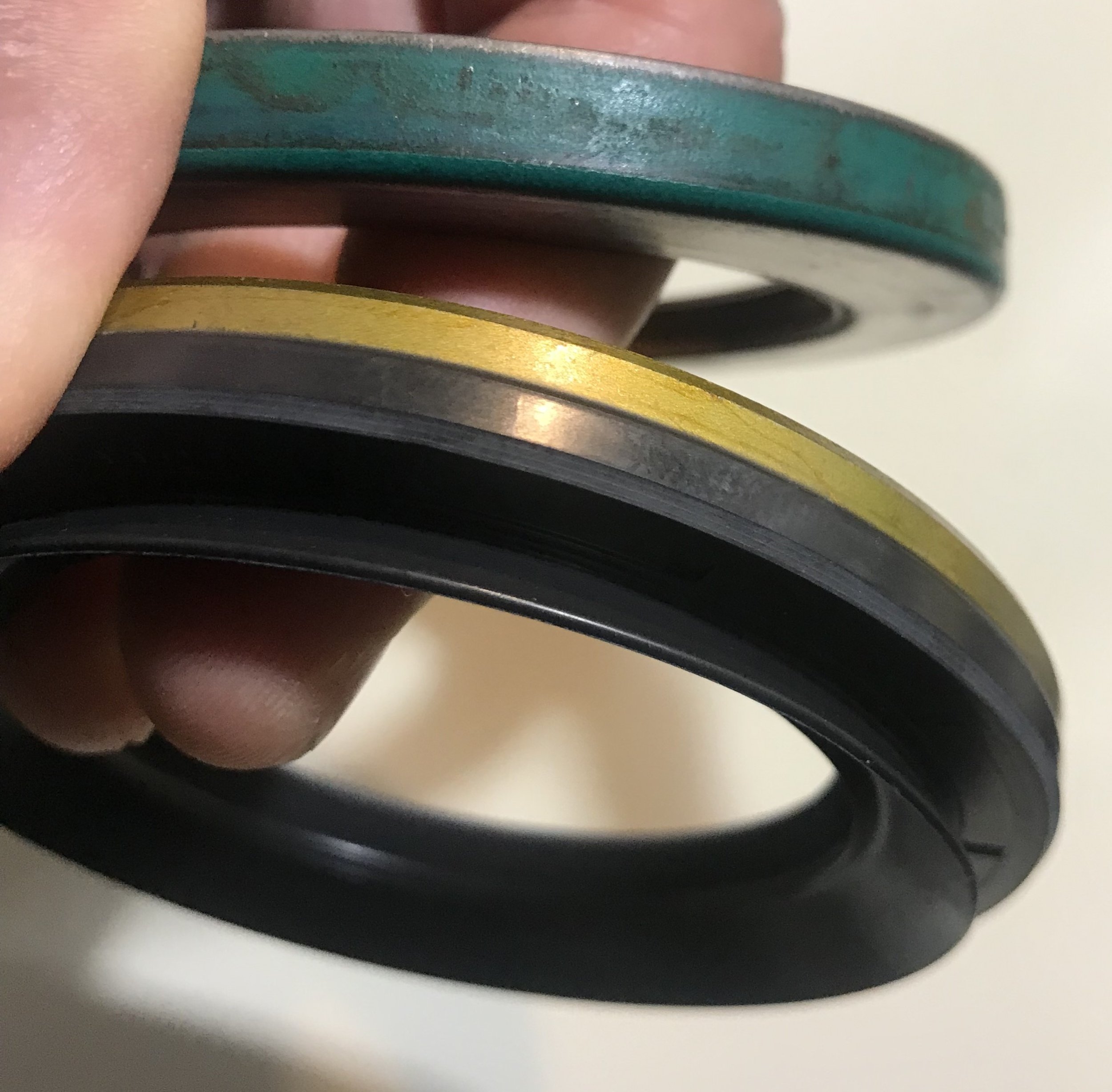

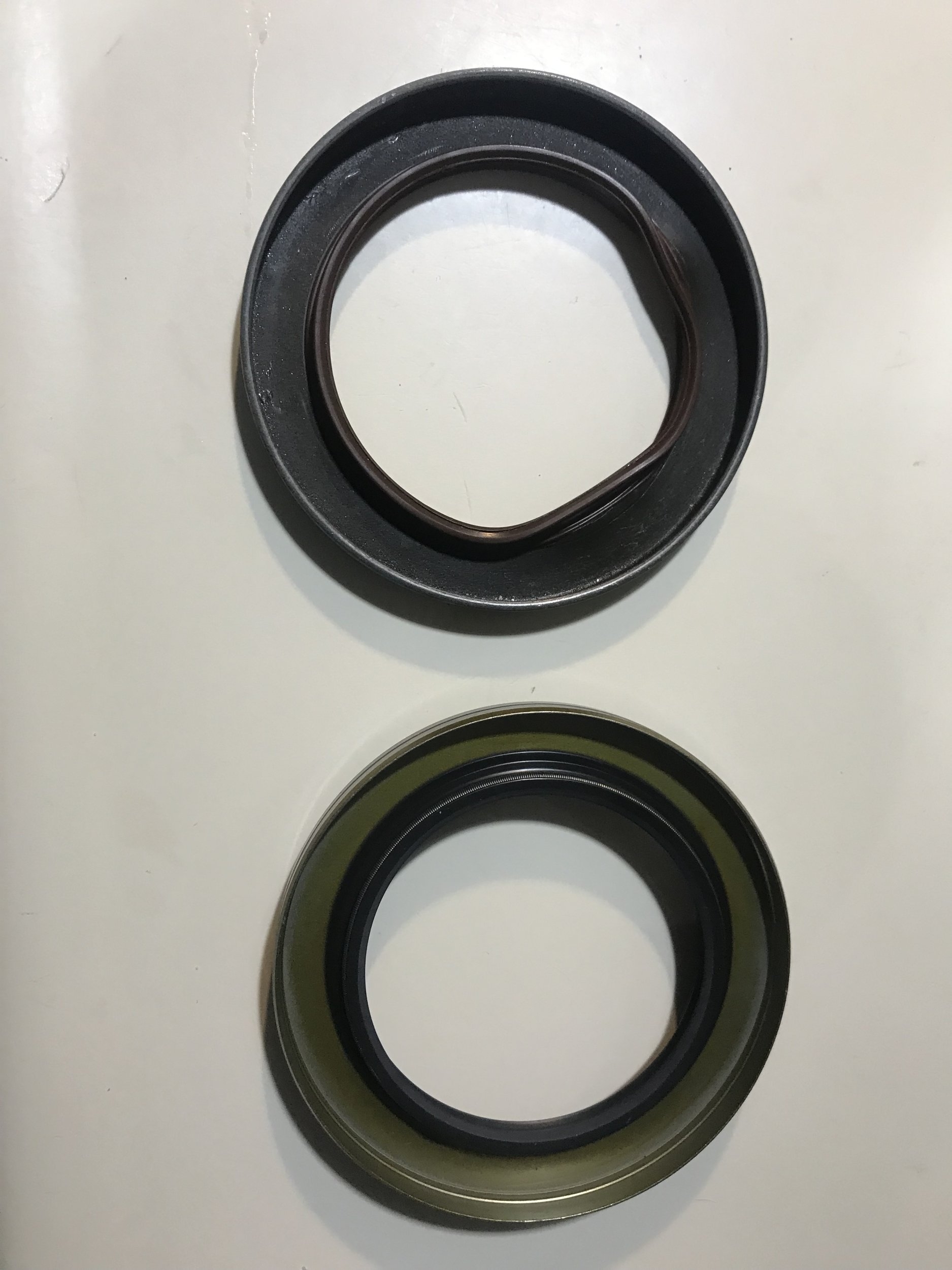

I have a 4x4 Model 4600 PowerReverser with a leaking right front hub seal. I removed the hub and checked on the local dealer site, where oil seal #35 on the schematic shows to be part #LVA14181. I ordered the oil seal from my local JD dealer but when it came it the replacement seal is a double lip design whereas the seal I removed is a single lip design. I asked the parts guy about the difference, he said it's possible that the double lip seal is a design improvement, but he doesn't know for sure. I paid $39 for the seal, so it's not like I'm ok with giving it a try and then replacing it if it's the wrong seal. Anyone have any experience with this subject?

I'd rather have the double lip in that environment.
   / JD 4600 Front Hub Seal Replacement #3
Agree with Harry -double is better than single here so long as the dimensions are the same
   / JD 4600 Front Hub Seal Replacement #4
I guess if I had to choose, then I'd lean toward the single lip for things that see a lot of dirt, not much water, and aren't protected with felt wipers. That would be most axle seals or hydraulic cylinder seals.
But I also don't think it makes much difference. If it were mine, I'd use the seal you have in hand if it fits.

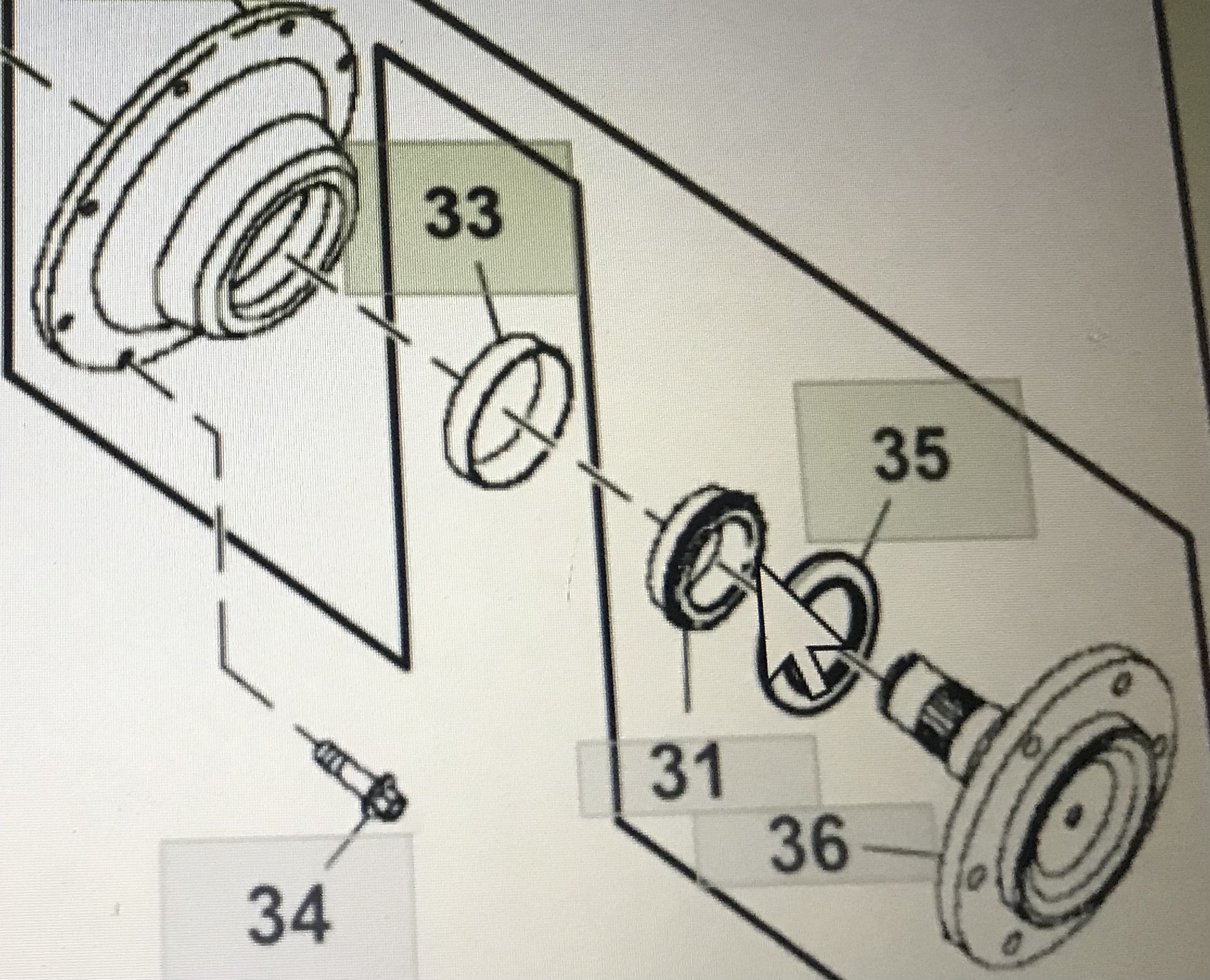

JD Parts shows your original part #LVA14181 and what appears to be an upgraded "Seal Kit":
#35
Seal Kit
Part Number SJ14405
Description
Seal Kit - SEAL KIT, SEAL,FACE
That may be the double lipped seal you have and it may or may not require the upgraded housing.
See illustration numbers #32 & #35 on the IPL.
The 'Housing' #32 is to the left of #33 in the screenshot you posted
You should go past the Parts Desk to the Service Desk and seek confirmation.
