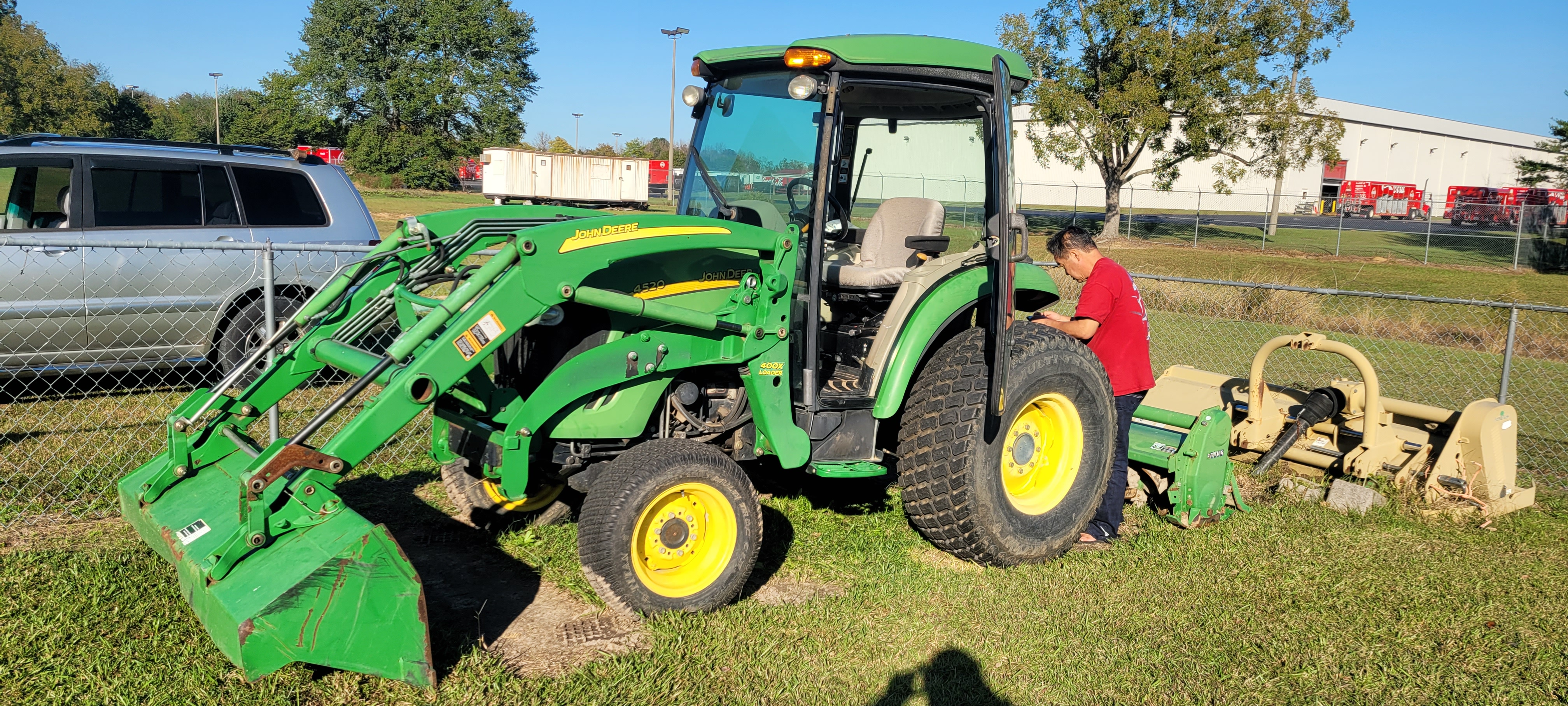

Context: Helping a church fix up their JD4520. We only have surface knowledge on how to work on tractors. It has a front Loader and rear equipment hooked up. According to them the Tractor has been sitting for several months. It has been maintained by the JD Dealer before.
What's Wrong:
  • Front and Rear Hydraulic lifting movement is VERY jittery. It jerks up in a manner like climbing stairs compared to a smooth ramp.
  • The pump whines and sounds like it winds up pressure and releases inconsistently, only then do the hydraulic lines actually jump slightly.
  • The Power Steering is also inconsistent and works in pulses.
What We've Done:
  • Changed the Trans/Hyd fluid filter and fluid.
Result: Tractor still behaves the same. We couldn't find the "Screen" former forums have discussed.
Additional info: Engine and other accessories all function well, the primary problems are have been isolated to hydraulic issues.
Question: What are we missing? We are seeking help by local farmers/tractor maintenance people for any advice.

To confirm, this is the compact 4520, not the Ag 4520?
Hydrostatic transmission? or PowrReverser?
A picture of the tractor may help..
A pressure test of the various hydraulic ports may lead to the problem..
And can it be taken back to this dealer who maintained it before?

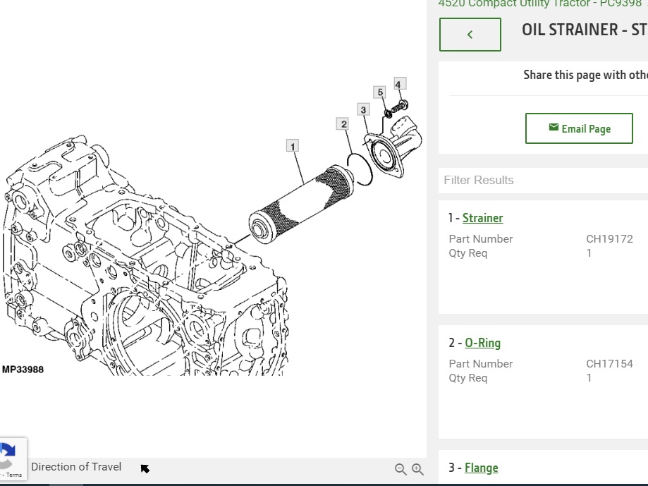

Parts can be found at the JD site
https://partscatalog.deere.com/jdrc/navigation/equipment/68742
Oil strainer as shown in parts.

The screen is the bottom of the transmission and has a hydro line of guessing 1 1/2 inch size going to filter. near the right tire and loosen 2 metric 10 bolts and if have not drained the fluid you just did. when the pipe is loose just pull apart held in place by a rubber seal. from the filter then reach in and remove the filter wash in diesel fuel. (once had a tractor brought to my shop for repair and had no power the screen was full of green or dried grass former owner failed to put fill cap on and mowed weeds with it.)
if the hydraulic oil has sediment or oily water maybe without running flush with diesel. also, I do not have any luck using other than John Deere fluid. 76 bucks a 5 gal. container if this clears the problem. system flush might be needed.
