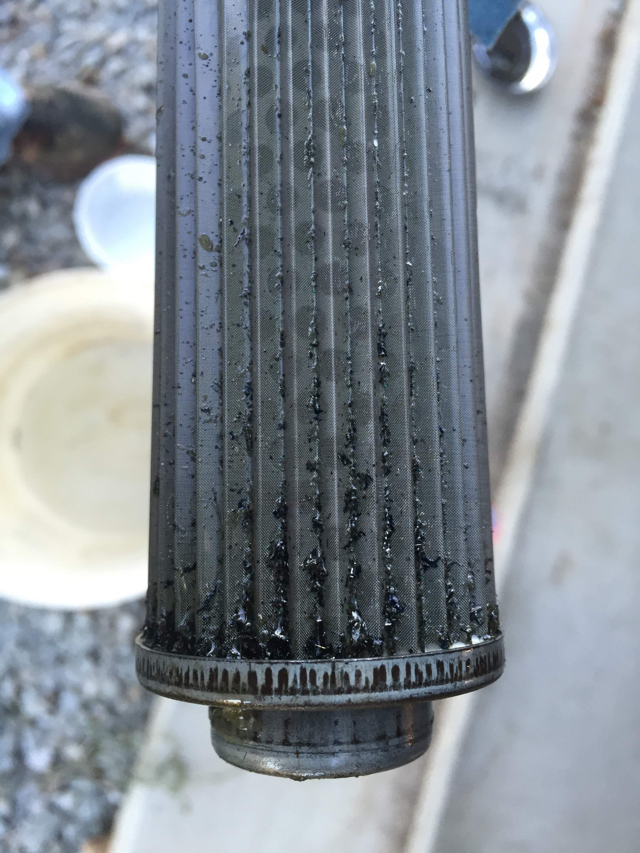

Ok, so my original post was how do I get the suction screen filter elbow loose from the hydraulic line? Found advice elsewhere - duct tape on vise grips applied to large line - worked back and forth - it came off ok.
Now, however, I'm a little concerned. I have experience "jerky" hydraulics (see below), and was after the suction screen to clean it out. I got it out, and found a decent amount of crud on it. But what really concerned me was the number of metal shavings (see attached pics). Is this something that's "normal"? Or do I have a big problem brewing?
Thanks
Background:
I have a compact 4320 E-Hydro. It's about 5 years old, about 700 hours now, and was at the dealer last year for a 500 hour service, including hydraulic fluid change. Last week, it started having "jerky" hydraulics: the steering is alternately fine then sticking during a turn, and the the loader jerks the first 12-20" when being raised, then settles down. Seems to be worse when the PTO is engaged and I'm brush-hogging.
So ... investigated, and found the tip on the forum to clean the in-line hydraulic filter on the left side under the frame. I think this is the power steering filter. That was not too bad, but I cleaned it, and it got maybe a little bit better. Talked to the service manager at the dealer, and he recommended cleaning the suction filter screen. That's where I am now. Before I put everything back together, is there something else I should be doing?
Thanks in advance.

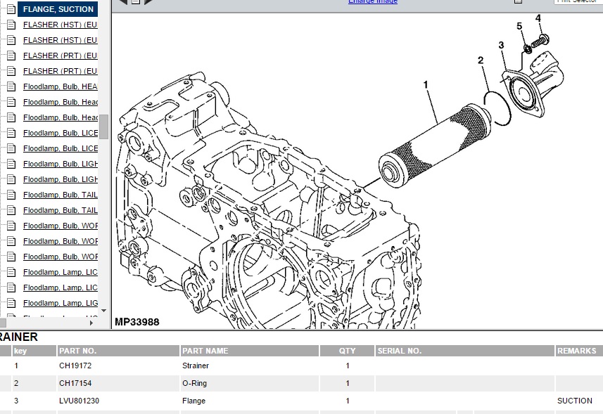

Does this look like what you are working on? Calling it a "suction strainer" . From the jdparts.com site.
   / JD 4320 Hydraulic Help - Metal Shavings
Yep - that's the beast alright

If that's the first time it was cleaned, then yes it looks to be a normal amount of shavings from the manufacturing process. If you look close, the shavings probably look like drilling and milling remnants.
I wonder if the dealer skimped on cleaning the suction screen when it was serviced last year?
Thanks Arlen - I had the same thought as I was trying to wrestle the elbow fitting off - doesn't seem like it's been off before. That was pretty disappointing to me.
It does look more like manufacturing leftovers. Thanks for the reassurance.

My 4320 had a fair amount of metal shavings in the strainer when I did the first transaxle maintenance. Do all my own maintenance that is not covered under warranty. And, yes it was a ***** to get off and especially back on and in place. I never experienced any issues prior to doing the maintenance procedure. Hopefully that does the trick for you.
This has been my experience as well on first time cleaning of suction screens.
Thanks for all the help! Cleaning the suction screen - which led to a hydraulic fluid change and spin-on filter change - made the difference. Steering and loader operate like new :D
Wish the dealer would have cleaned the screen when they did a fluid change last year. Also, I'm a novice mechanic, but that hydraulic elbow removal and replacement was no fun at all
