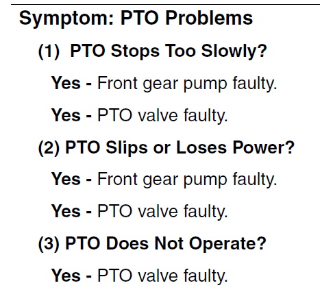

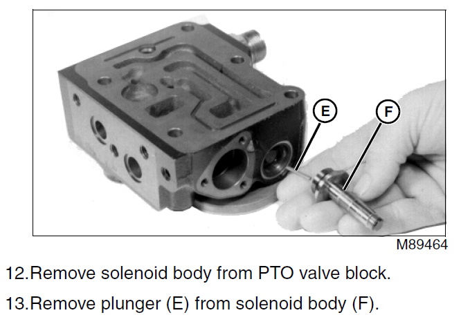

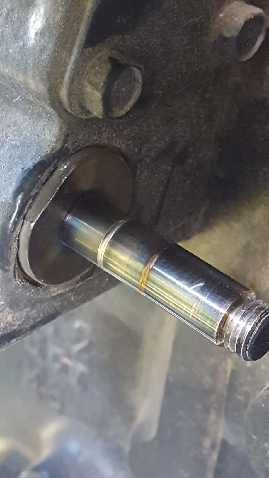

The PTO is slipping enough to where the brush hog blades are stopping in normal pasture grass so my search for a fix is in motion. First part I want to rip apart is the PTO Valve body.
Has anyone ever removed the solenoid body from the valve block that can tell me what the secret is? Those flats aren't enough to grab a hold of and I'm starting to bugger them up pretty good.
Couple of pics attached for reference. M89464.jpgfault.jpg0d61ac5841c3ea8fe88aa19f9f7fbae14fcb7d9b-1.jpg
