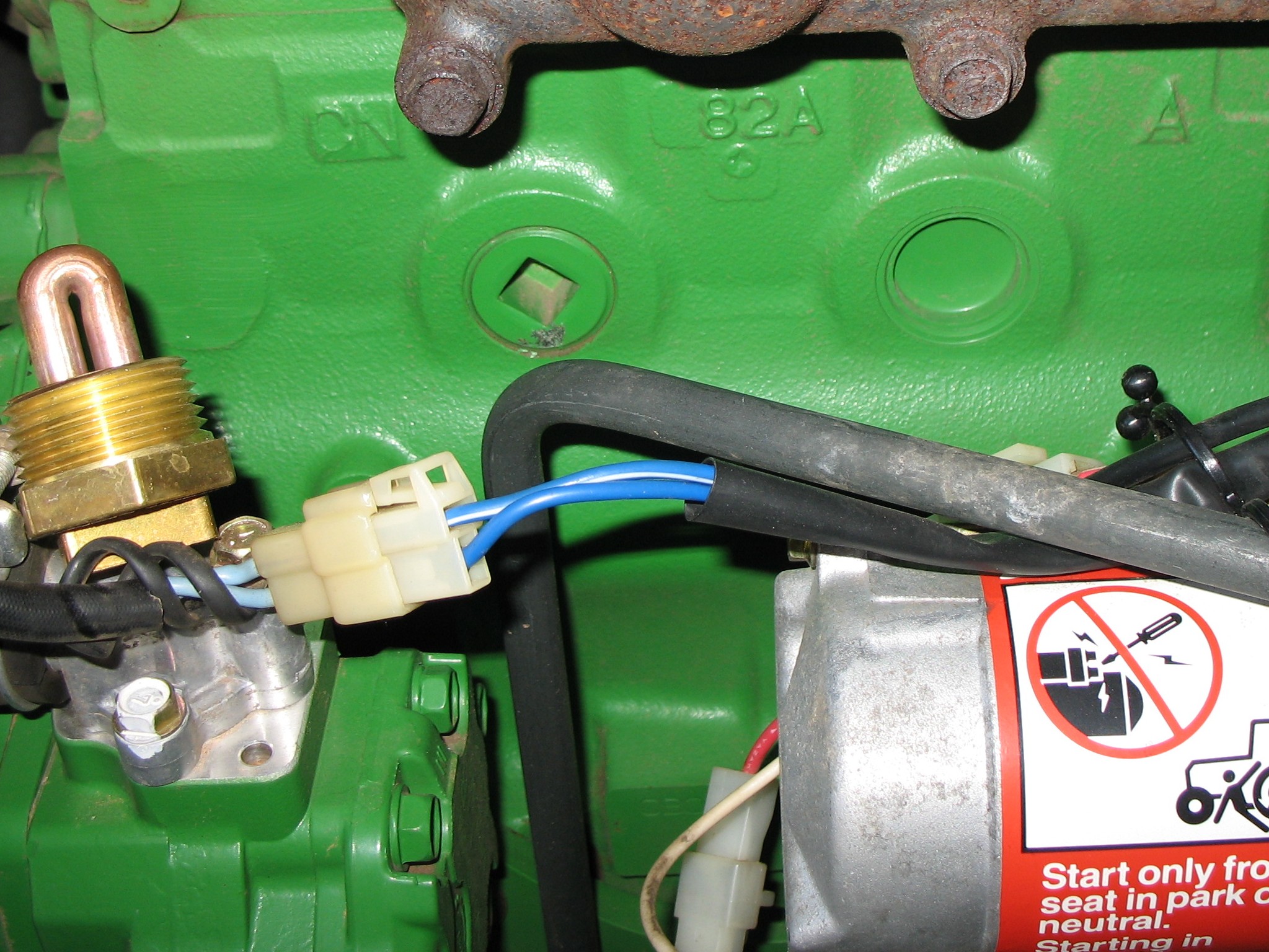

Late summer I installed a Block Heater on my JD790 (Attached PIC), looks like a different style than yours (sitting left in the PIC). If you search on my user name you'll find the thread about installing block heaters. The challenge, getting the engine plug off so you can install the "dad-blasted-thing" took me about an hour then in my case, "let the fun begin" installing the heater located right behind a rigid hydraulic line with a nice 90 degree bend.......:confused2:
Hope this helps.........:thumbsup:

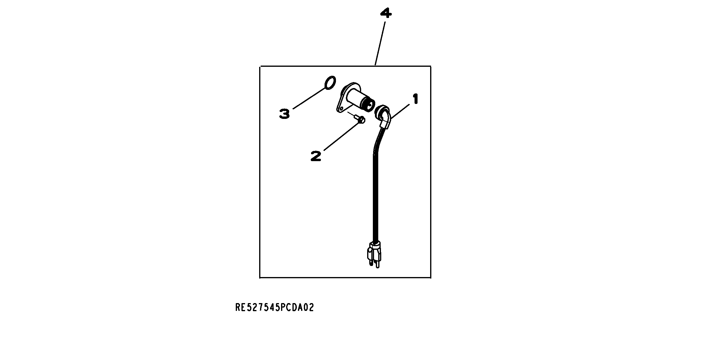

I think I've come to the conclusion the parts house sent me the wrong part. That RE235938 heater is 2" in diameter. All the plug locations are 1 1/4".
I went on JD Part's site myself and did a lookup based on the part number in my operator's manual (RE520167). Looks to me like that part was replaced by RE527545. Based on what I see in that picture, that one would fit as well.
RE527545 Coolant Heater 1 110V, (SUB FOR RE520167)
