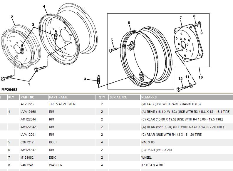

Does anyone know if they share the same rim size or is it different? I just bought a 4300 off ebay and it has turf tires on it and I'm wanting R4's. Does this tractor share the same tires and rims with other Deers?

Looks like the rim diameters are the same (per the link that Glen so kindly provided), but if you want to be sure, sign up for JD Parts and get the wheel part numbers.
I've had R-4s and R-3 (different tractors though) and, frankly I just never noticed if they're the same rims. I can tell you the rims for Turfs and Industrial are welded (rather then bolted like the Ag rims are).

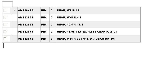

Here are the four different rims for the 4300, per jdparts. Also, a pic of the rims of the 4410 which is similar to the 4300, including the split wheel/rim. Some part numbers the same and a bit more descriptive given for the 4410 parts.
Different PN's and sizes for the R-3 and R-4 rims (AM122842 and AM122844) so they are interchangeable even though they look quite similar.
Looks like BRBurns is goingto have to buy tires and rims if he wants R-4 tires.
   / JD 4300 Turf Tires and R4 tires #7
Right Roy. That was what I was pointing out in my post, that the rims are different. :)
