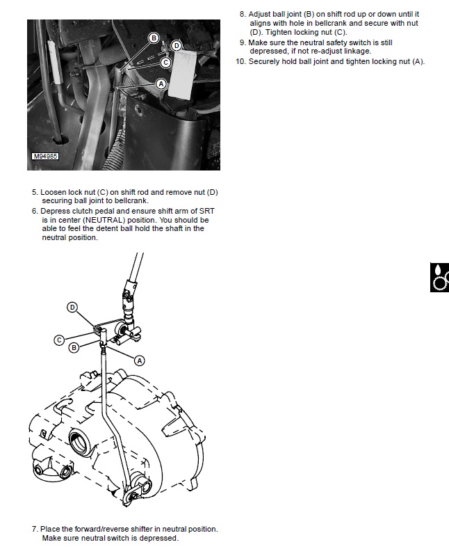

With scr lever in neutral and/or all gear levels in neutral position the tractor will creep forward if parking brake is not engaged. Also if not attempting to move forward there is still a drag on the engine which all stops if the clutch is pushed in. Ideas?

The service tech manual shows adjustments to both the clutch linkage and the shift linkage, so getting the service tech manual may be your next step.
May not be your problem, but sounds like it.

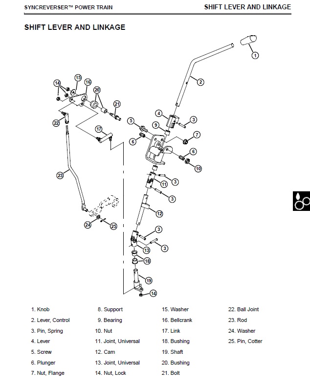

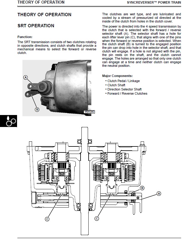

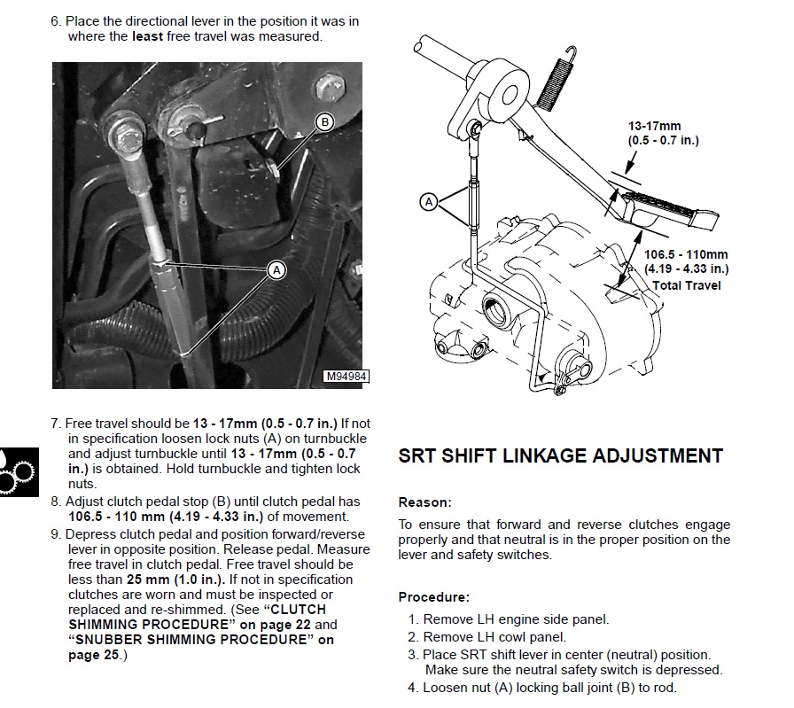

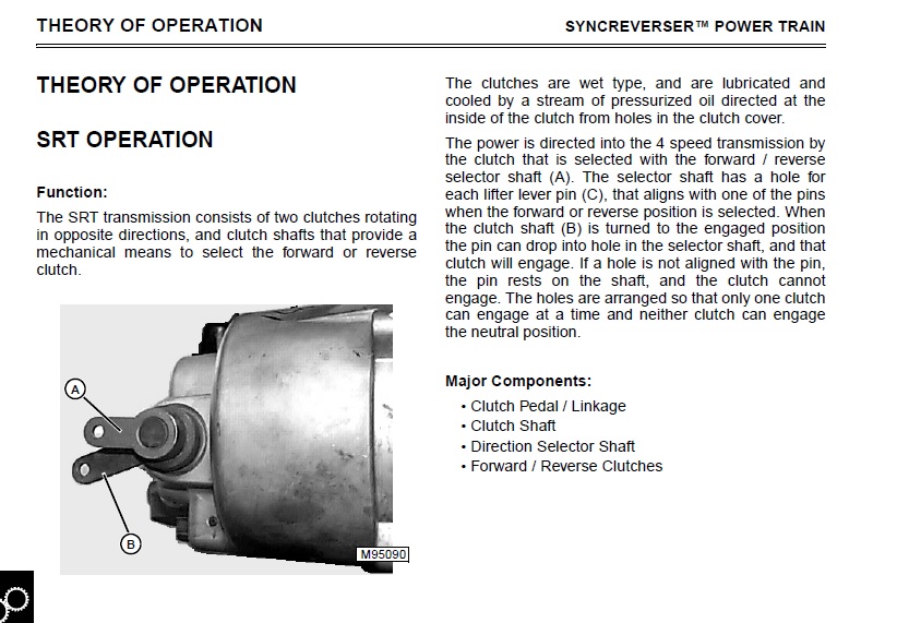

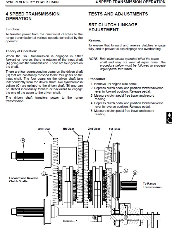

Here are some other pages from the tech manual that may help.. hopefully will give you some ideas.

I was just wondering if this is a new problem or ongoing? Is tractor new to you? If transmission gears are in neutral, it shouldn't be able to creep regardless of forward / reverse or clutch adjustment. Transmission being overfilled with oil can cause issues like this. How is your oil level? WHat kind of oil is in transmission? Should be LoVis Hygard. If heavier oil is used, could also cause this.
