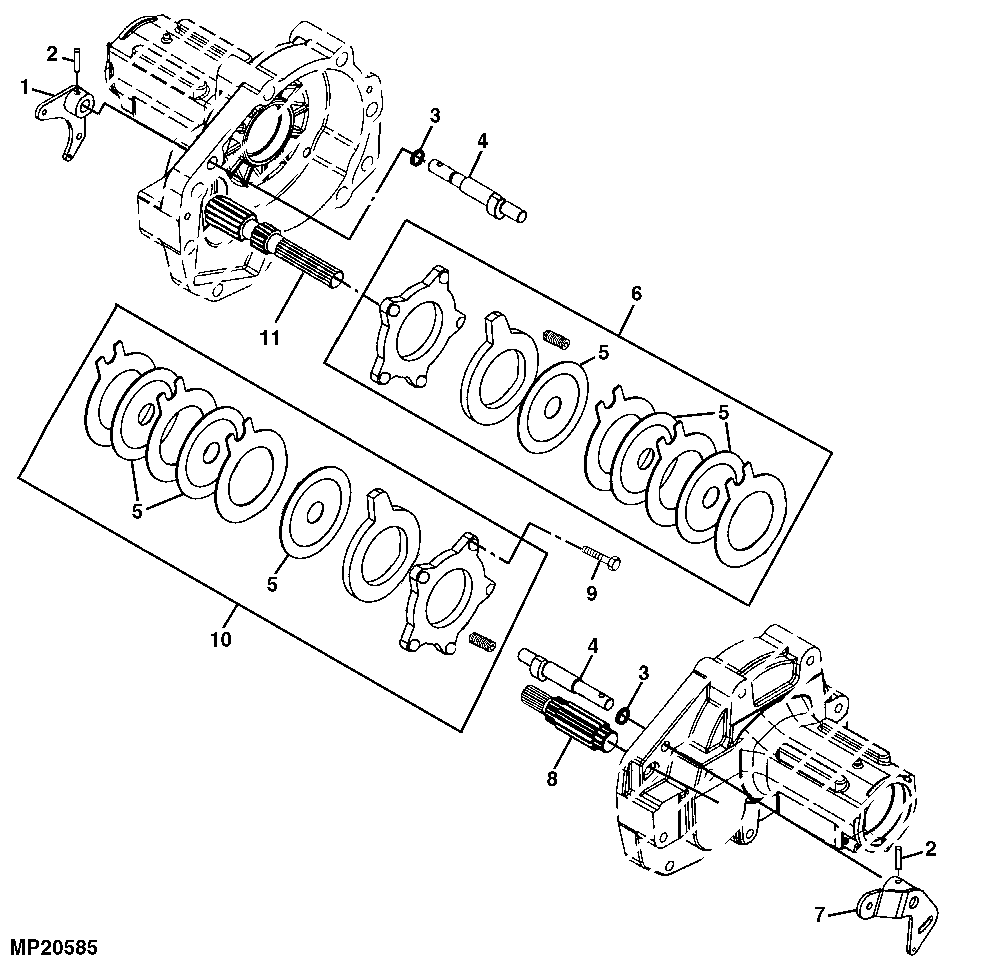

While plowing snow a few days ago in 4WD, my 2000 model HST 4300 started dog-tracking as the right rear wheel stopped spinning. I've tried to find similar threads on this issue and I appoligize if this has been answered already.
I've checked the hydro fluid level and it looks good, about half-way up the glass. Does anyone have some pointers in terms of trouble-shooting before I have the dealer take a look at it? Thanks in advance.

think your brake in binding on one side,,,,,the side that the wheal is locking. I have somewhat the same tractor but 4400 and I know, read this on a tread here that the input shafts to the brakes inside the rear housing just over rear axial on both side have a tendancy to seize up and its a good idea to lube once in a while....metal shaft and aluminium housing not the best if its not this then open the rear housing and check. Good luck!!!

I have the same tractor too and this winter the brakes have not been releasing properly. Did you use the brakes just before this happened? Follow the rods the brake peddles atcuate back to a lever on each side of your differential. There is a small rod with a spring on the back side of it. Tap it rearword with a mallet and it should release. Luckly it is easy not to use a brake on a HST. I plan on fixing mine once I can get it to my Dad's shop to pull the wheels off.

I've always greased the fittings at the pedals and I applied a generous amount of PB Blaster to that area. The return spring looked ok, probably couldn't overcome the binding. It's been soaking a few days, I'm crossing my fingers.

Mine seizes up where the shaft enteres the brake housing. Have to crawl under with the penetrating oil and hammer. Tap the linkage into the release position, squirting oil. have the helper apply brakes and do it all again until they move freely.
Definitely a two person job. Best way to prevent it is to USE THE BRAKES, even though you seldom need to with HST....
   / JD 4300 Rear Wheel won't spin #13
i'm pretty sure this is the parts breakdown for the shaft in question here,
let me know if not, but you want to lube/work that shaft going
into the side of the housing so it doesn't bind and releases fully.
really just working it with some lube is all it should need, a helper makes the job
go quicker for sure.
