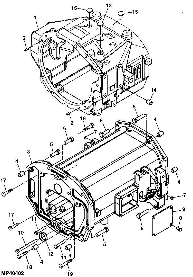

The only concerns pertaining to the 4200, 4300, and 4400 models are the rear axle housings being made of aluminum and the loader mast to tractor attachment can get sloppy. Check out http://www.tractorbynet.com/forums/parts-repairs/146974-john-deere-4300-complete-rebuild.html to learn more about the 4300. Note the unit you are looking at appears to have been well cared for, while the unit in the thread I provided was a used and abused rental unit.
