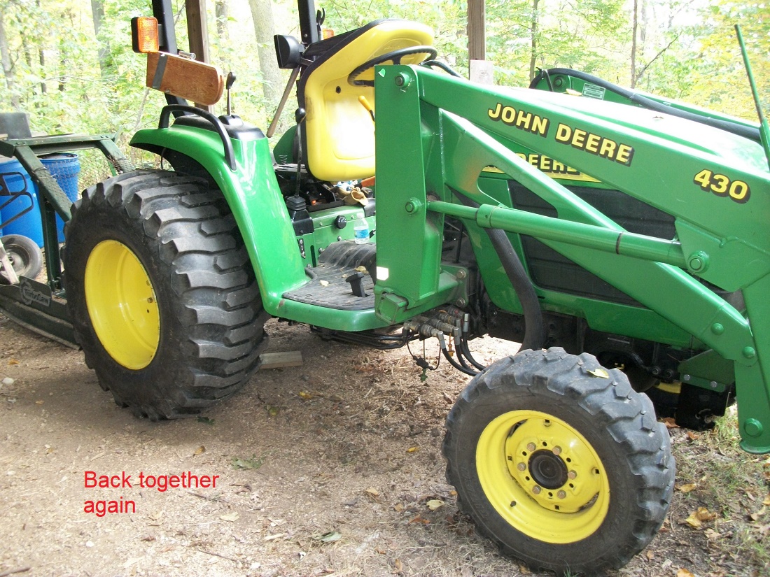

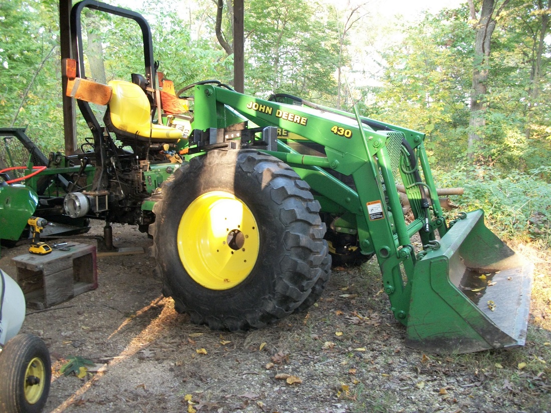

Shifting lever for the PTO clutch sheared the roll (spring) pin when disengaging clutch, leaving the PTO running the brush hog. Left it running to return to the shed, because shutting off the engine means cannot re-start with PTO engaged.
Removed right rear tire, fender, and cover over the linkages.
Removed the broken spring pin and replaced. Pic shows the parts disassembled.

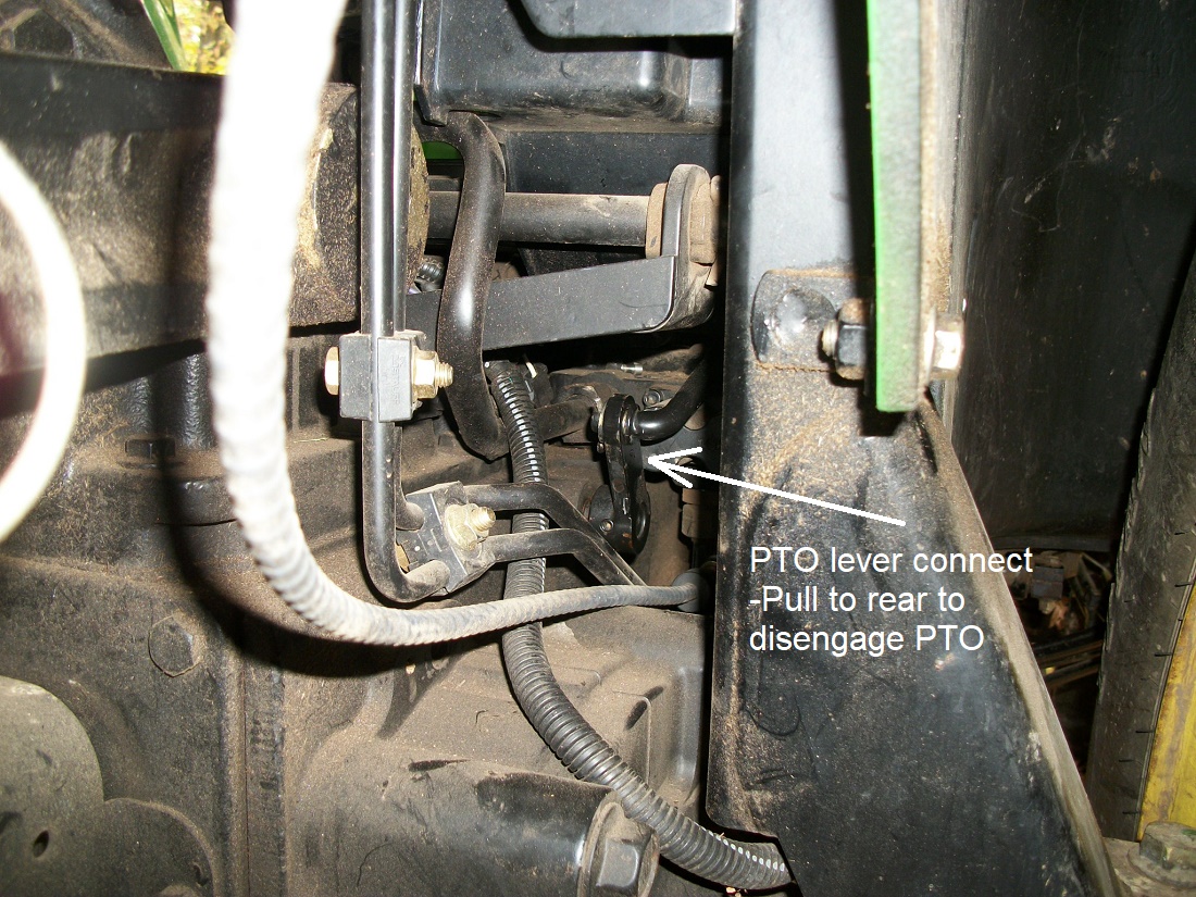

Reassembled and made note of how to release the PTO clutch if this happens again (without removing wheel and fender).
Last pic shows the PTO lever seen from the rear, that can be disengaged without removing the right rear tire and fender. That will at least allow the tractor to start and run.

It looks like in picture 3 that the roll pin was not all the way through both pieces. Was that the case? If it was, it would only have to shear the pin at one shear point, not two. :confused3:
   / JD 4300 PTO shift lever pin sheared
Before pic three taken, I managed to use the dikes to grab one broken end of the roll pin and it came out. Both ends were visible on first look.

Access to the PTO clutch engagement shaft entering the trans case.
