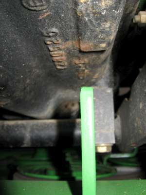

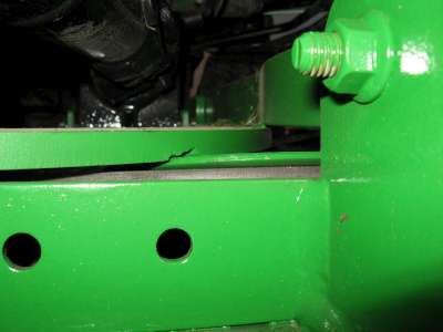

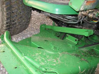

Ok, I got pictures now. I got the yard mowed too.
You can see that the deck is not fully lifted and agains the stops. About 1" from the stops. And the pully is rubbing. It has been like this for a while judging from the cuts in the lift mount that the pully has made in the past.
It's the pully top center of the fist pic.

   / JD 4300 Mid Mower Mounting #7
BR
In the deck lift parts layout I posted, look at part 37 (and related parts). There are two of these turnbuckles that likely need to be lengthened out to keep from raising the deck so high that it rubs the pulley.
Someone has shortened them too much, I suspect to get more ground clearance when not mowing.
When you get the deck manual, you will see how to adjust these turnbuckles so the mower deck is level right to left, and also how to adjust the front draft so the leading edge of the deck is a bit lower than the trailing edge for best mowing.
Thanks for the pics.

   / JD 4300 Mid Mower Mounting #9
I had a 4200 with the 72" deck for several years. I believe the reccomended adjustment for the lift-links was to have a 1/4" clearance between those stops and the tractor belly, when the deck was fully raised. I mowed some uneven areas where those stops would actually hit the bottom of my tractor, but I don't believe my pulley ever contacted that bar (like yours is).
Sorry, I don't have any suggestions to help your situation. I no longer have that rig, so I can't go look at mine.
   / JD 4300 Mid Mower Mounting #10
I don't think it is supposed to contact the stops. Adjust the links so when the deck is in full up position, the pulley doesn't contact the deck frame.
