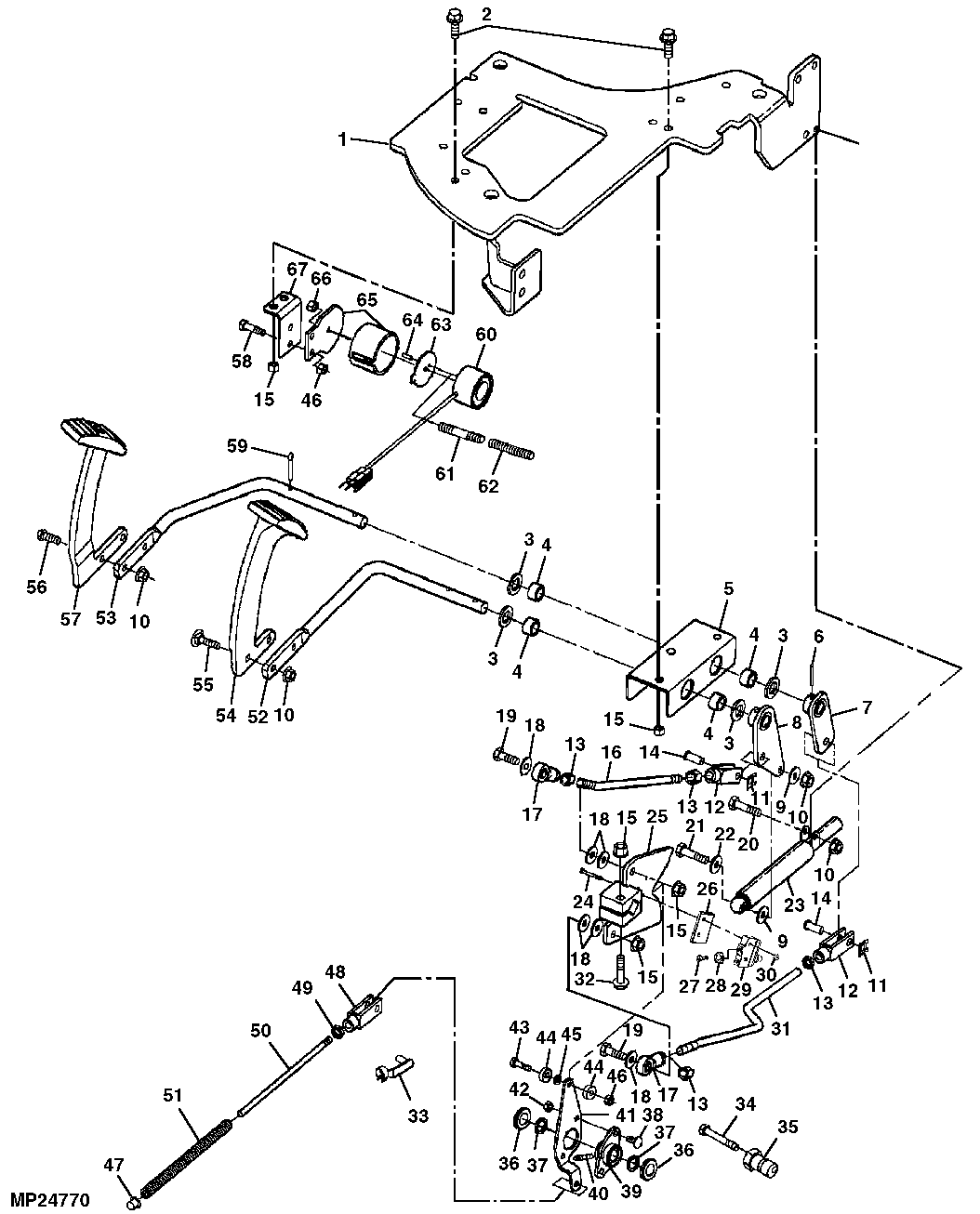

My hydrostatic pedal for forward travel sticks on and the reverse pedal has become almost unresponsive. Is there an adjustment that can be made to correct this problem?
   / JD 4300 Hydrostatic pedals sticking #2
There is not really an "adjustment" per say, but there are plenty of places that pivot that need lubrication-that where I would start. There is also a return spring...see the picture below.
   / JD 4300 Hydrostatic pedals sticking #3
If you look closely at Kenny's picture, you will see two tie rods with
ball joints on each end. These require manual oiling. Also there is a
small sealed bearing that runs in the V slot of the swash plate lever.
Don't forget that extra long zerk fitting on the pedal pivot, too.

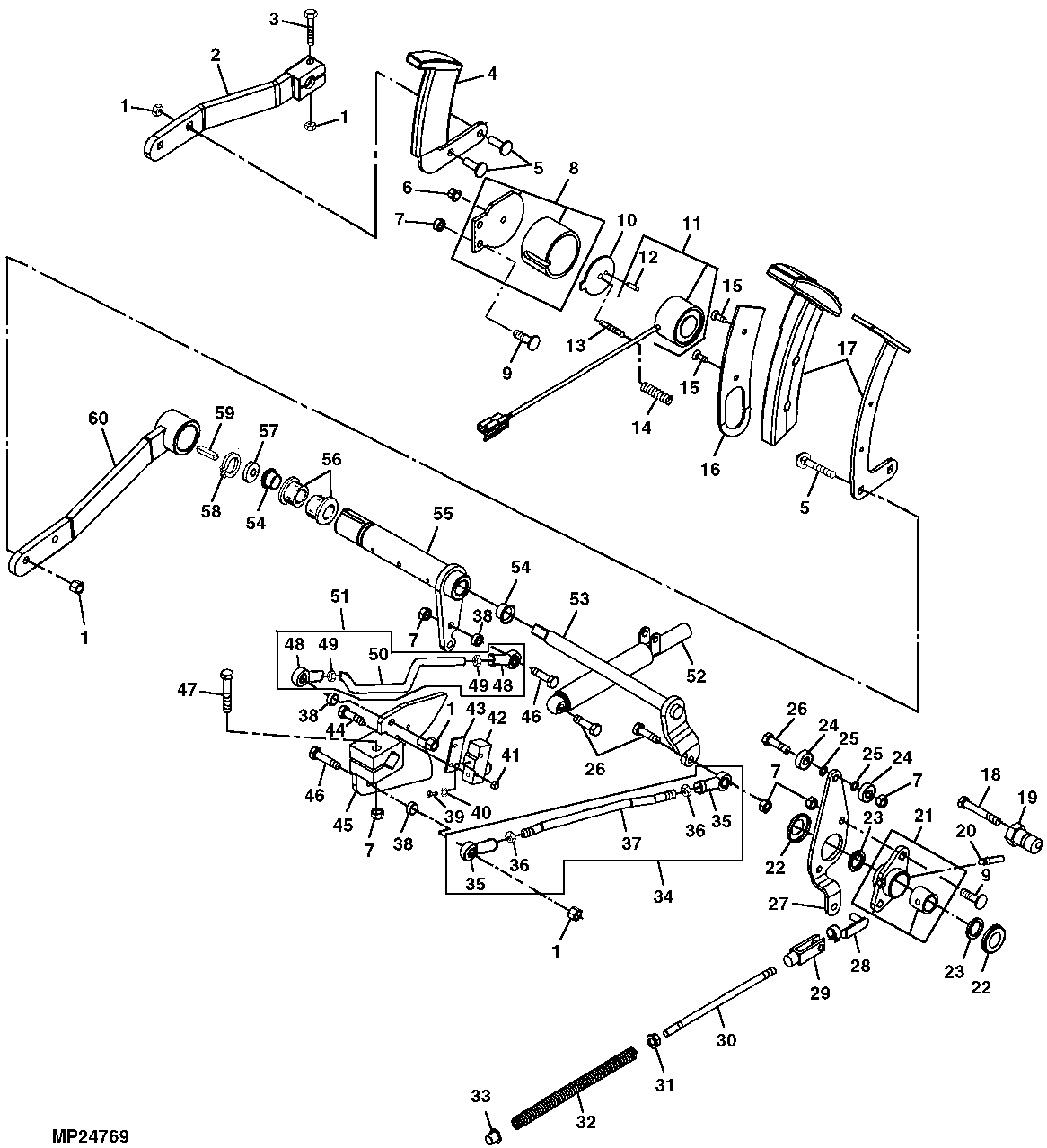

Anyway, I had tried the lube idea and gained little if any. It was too late. I had to crawl under and disasemble the whole assebly shown earlier in this thread. There is actually a spindle with a plastic or teflon tube / bushing. It was a bear to get apart. Rust had built up under the bushing and forced it out against the outside steel tube causing the problem. I purchased new plastic bushings (cheap) and cleaned every thing up, greased and reassembled. Works as new now. I keep it greased with it's fitting and hopefully it won't ocur again. If it does I know it is a realative easy and inexspensive fix. Let me know if this helps.

Actually after looking closer to the diagram earlier in this thread, it isn't the correct one for my tractor anyway. The 4300 HST looks more like this:
I am pretty sure the bushings that I replaced were items 54. Basically it is like a shaft inside a pipe with the bushings between. I probably didn't have to replace the bushings, just clean it all up and reasseble, but they were so cheap (a couple bucks) it just made sense.

I just repaired mine. I thought it as the bushings too, but after watching the mechanism operate through its range, I found that the Pivot (P/N AM118908) was worn and allowed the cam follower to cock sideways and the the follower bearing to slide off of the cam and bind the mechanism's return.
I replaced all the bushings, follower bearing, and peddle end links too. The end links required some trial and error length adjustment before there was full range of movement forward and reverse.
The pivot is easy to replace from beneath. I had the deck off, so I don't know how hard the rest of the assembly is to R&R from beneath.
