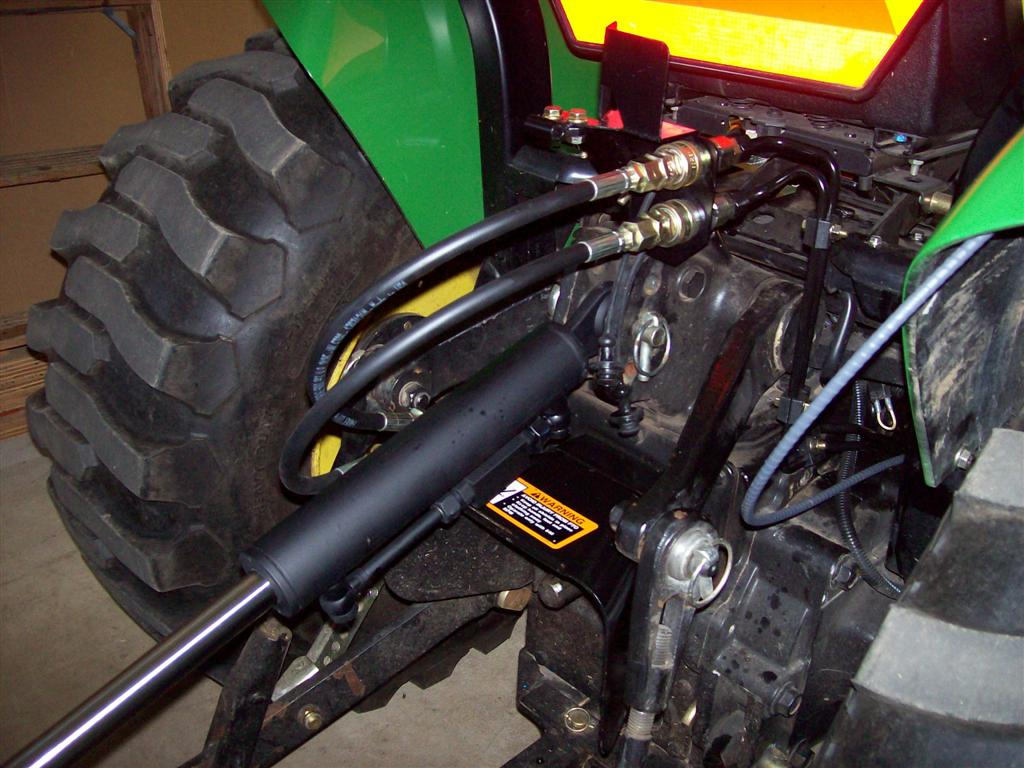

how do I know what hydraulic top link I need for a John Deere 4300 and any suggestions where to get one ?
   / JD 4300 Hydraulic top link #2
A moment to look.. do you have the rear couplers with the 3rd SCV?
I do have the rear couples with a control stick, not sure what SVC is
   / JD 4300 Hydraulic top link #4
SCV For Selective control valve, I believe. Two for the Front end loader using the joy stick, and a 3rd added with often a lever on the right fender to control the rear couplings.
Cylinder I purchased from Carter & Carter Machinery in TN. Was an 18-26 cat I with check valve. I read that as it is an 8" throw with movement from 18" to 26".
