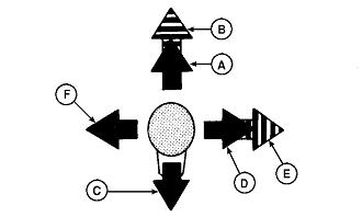

Dealer just installed the T-n-T and 5th SCV valve on my JD4310 tractor. I noticed that the joystick now controls the loader totally opposite from the way it used to. I know I can swap the hydraulic lines to correct this, but what is the correct joystick operation for the loader. If you push forward on the joystick, shouldn't the loader come down. And if you pull back, shouldn't it raise the loader. Pushing the lever left curls the bucket and pushing right dumps the bucket. Let me know if this is different.

They are swapped. All you need to do is swap the lines at the quick couplers. The color coded caps slip off and they managed to get them crossed.
Key Lever Movement Loader Operation
A Forward Boom Lower
B Locked Forward Boom Float
C Back Boom Raise
D To Right-Hand Side Bucket Dump
E To Full Right-Hand Sidea Bucket Fast Dump
F To Left-Hand Side Bucket Roll Back
Colored Couplers on Hose Couplers Colors on Coupler Plate
Red or Silver (Head-End Bucket Cylinder) Silver (Port No. 2)
Yellow (Rod-End Bucket Cylinder) Yellow (Port No. 1)
Green (Head-End Lift Cylinder) Green (Port No. 4)
Black (Rod-End Lift Cylinder) Black (Port No. 3)
My bet is yellow and black are swapped...

Wow -- nice picture rockyridge!
My 4400 w/430 FEL doesn't seem to have the "fast dump". Is there supposed to be a detent on the lever like the forward float position? And about how fast is the fast dump supposed to be?
