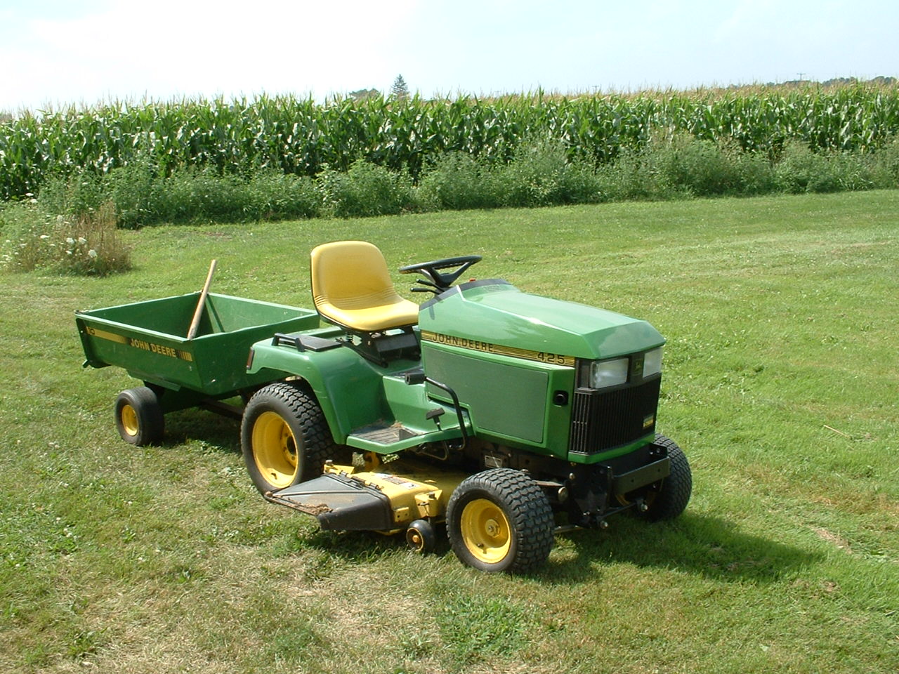

Had a 425 since it was new, only have 350 hrs on it now. RTV the rear reflectors in, to keep them in. If mine has been setting for over a couple of weeks, it will take a little longer cranking to fire up. Warm just touch the key and it fires up. Run it for a while to warm it up, shut it down and pull the air cleaner to make sure the fuel is not boiling in the carb. On the mower deck try to check the oil in the gear box, a lot of people forget this (big bucks to replace). Price seems a little high for the condition you state, so maybe offer $2500. so you can replace the broken pieces and tune it up! Good luck
