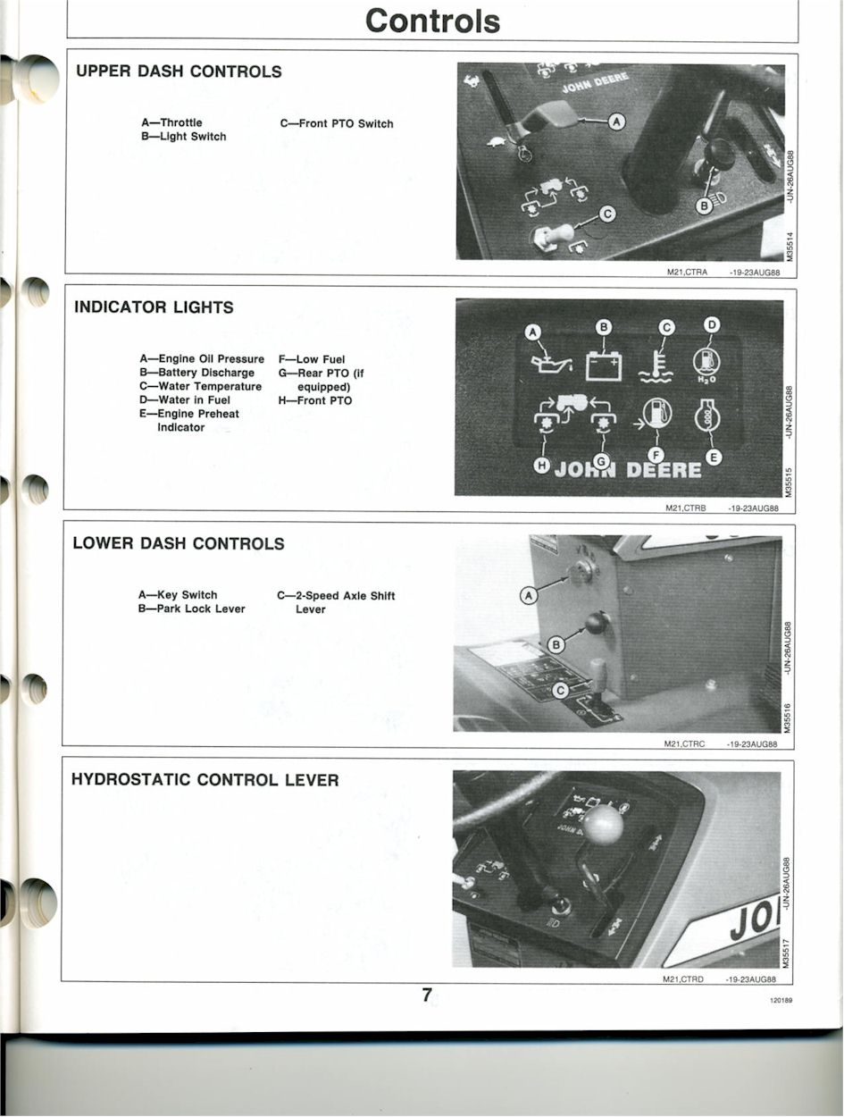

   / JD 420 Lawn and Garden PTO problem. #6
how do you engage the pto on a 420 john deere
   / JD 420 Lawn and Garden PTO problem. #7
When the optional rear PTO is added to the tractor, a second electric toggle switch is added to the dash next to the front PTO switch.
