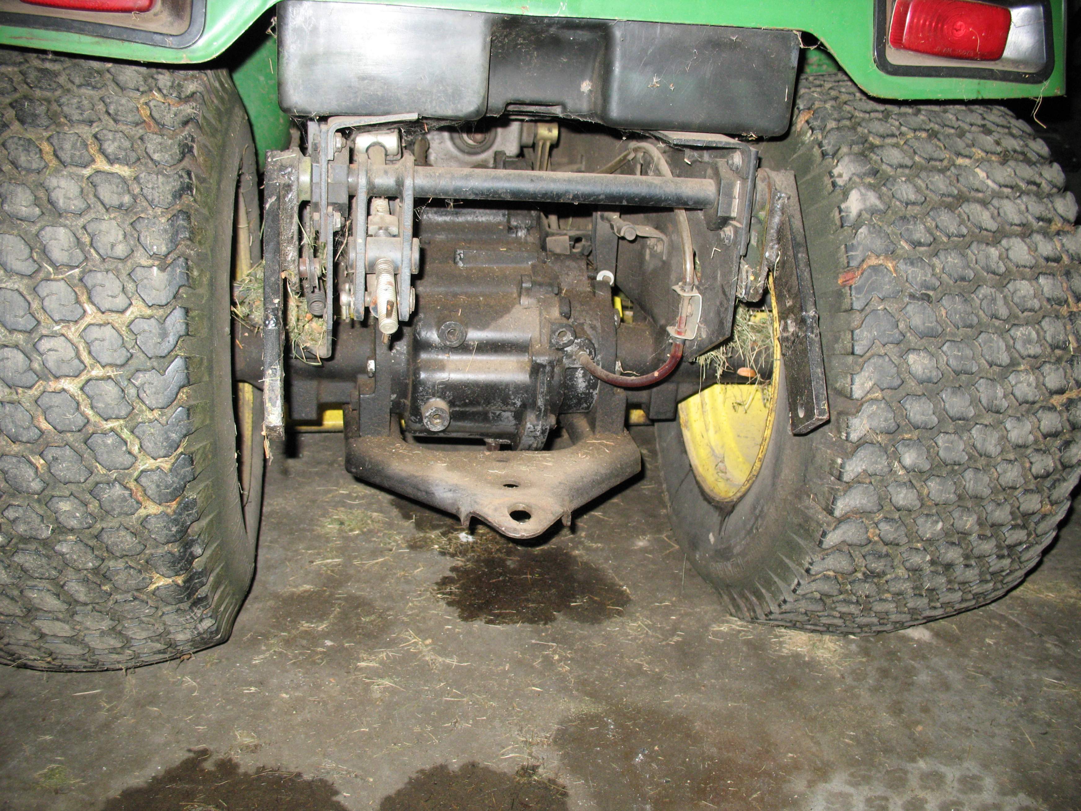

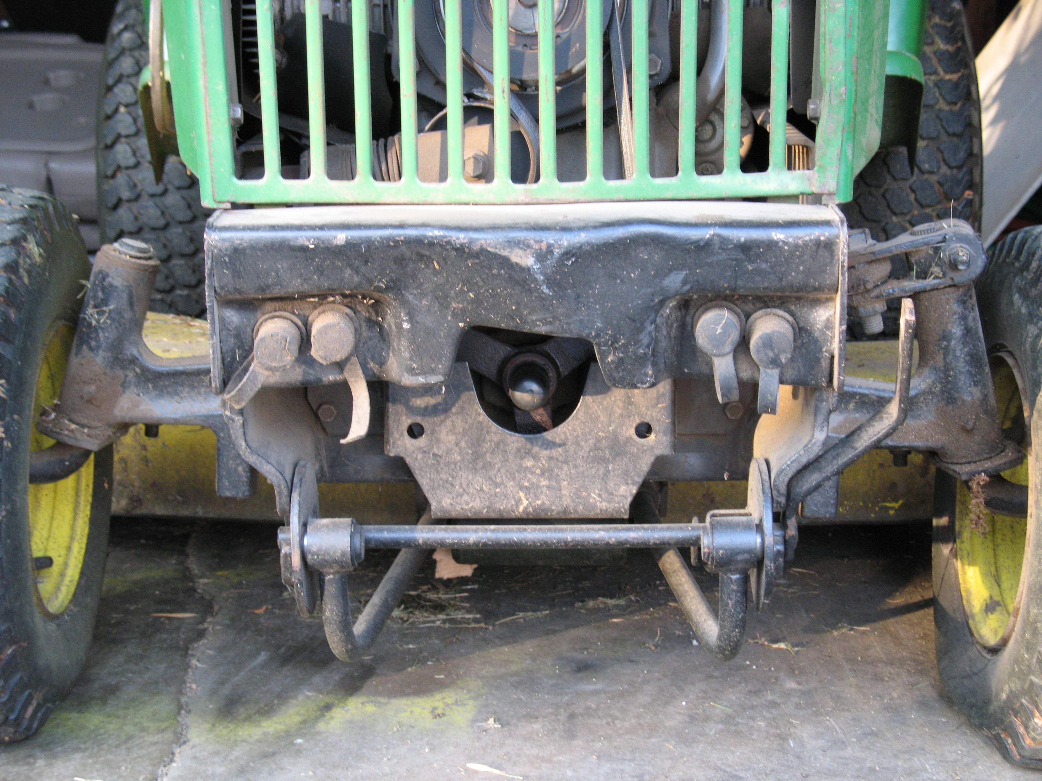

I'm not sure how this works but I hope this leads to the pictures I just took of my 420. It does need a new spring for the belt tension on the 60 inch deck. Maybe from these pictures you can see what I have?

Looks like you have the rear 3 point hitch kit and two extra sets of hydraulics at the front in addition to the hydraulic up/down of the deck. On the misfire, how long does it run at first - seconds (choke issue) or minutes (maybe valves need adjustment) Hope more people who know about this rig will chime in.
