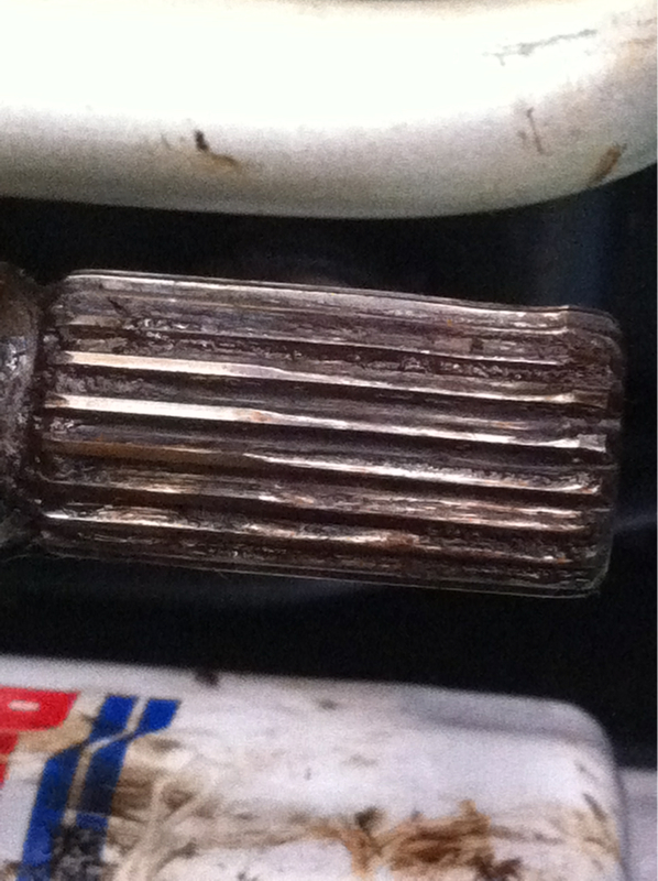

Ok. I've learned how your supposed to go about changing the u joints on the drive shaft. Now, I'm trying to figure out how to get the driveshaft out. I took the four bolts out where it's connected to the engine, but it still won't budge. Is it just froze and needs banged around a little bit, or is there another step? Thanks

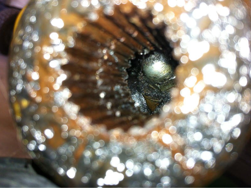

Well I got the shaft off. The u joints seem to be good. But the yoke that slips on the transmission shaft is worn and the transmission shaft itself seems worn. Now what do I do if the transmission shaft is worn? Yikes
