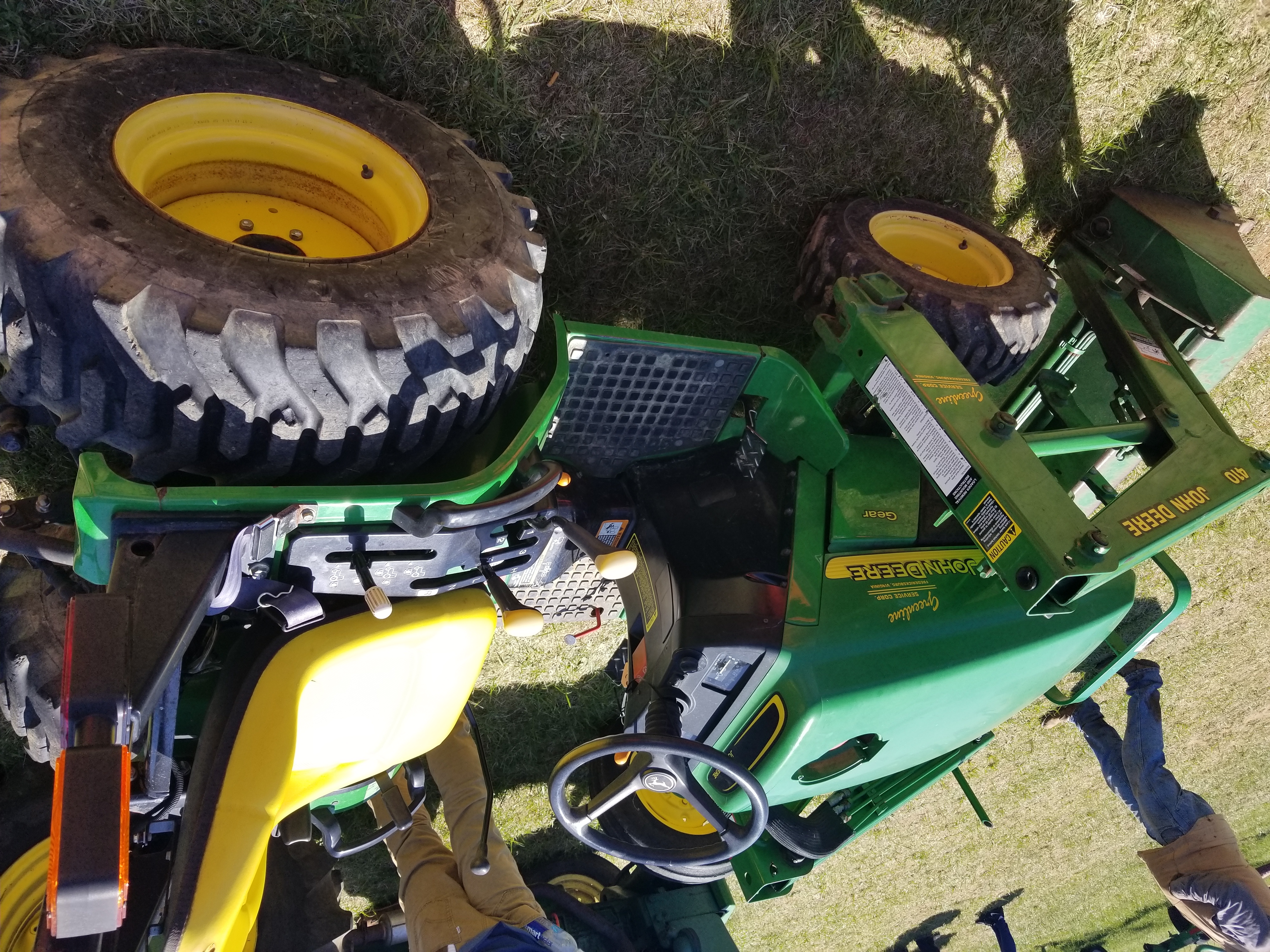

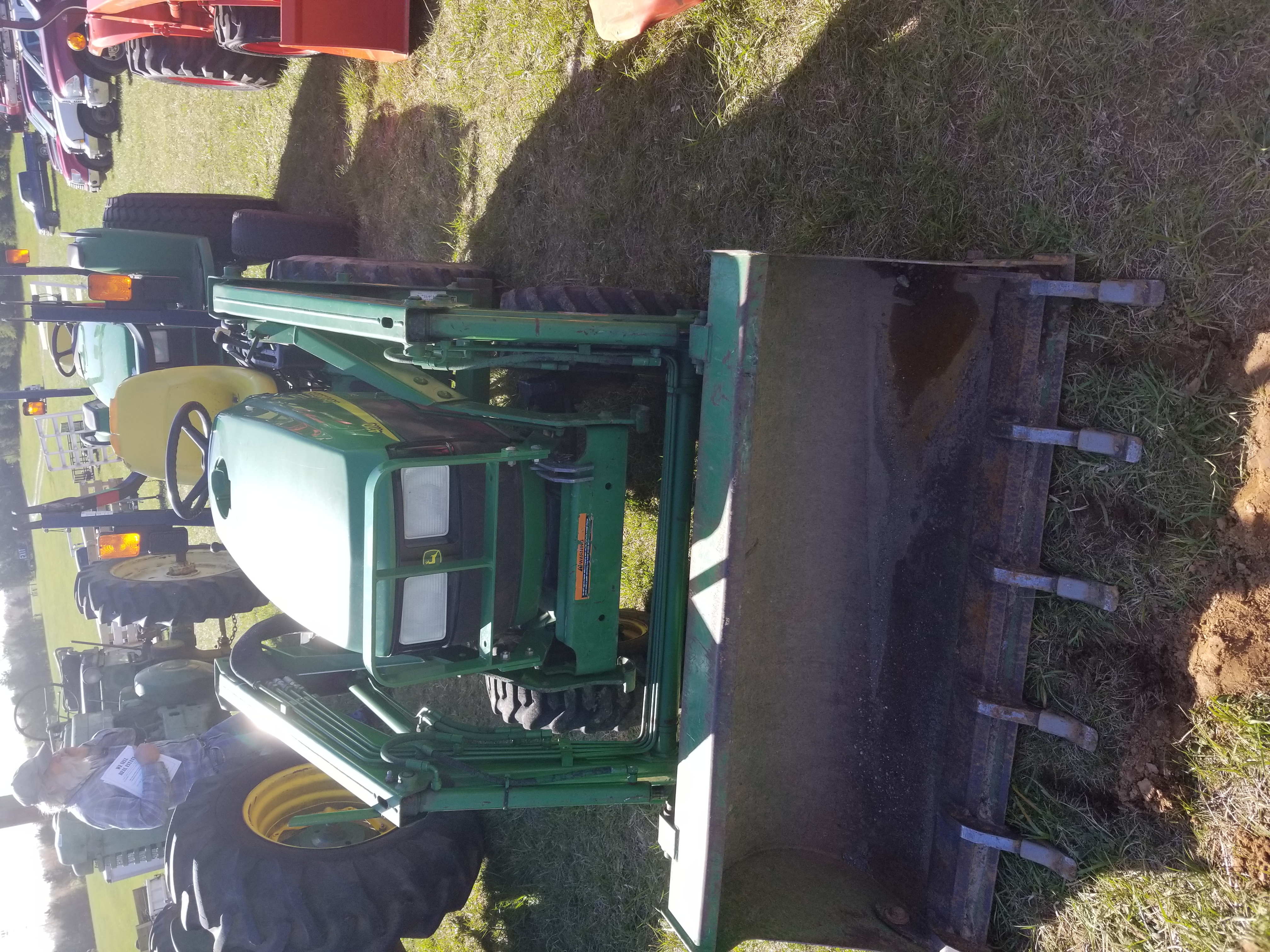

So I have been hunting for a subcompact for about a year now. I was at an auction yesterday and purchased a JD 4110 with 404 hours on it. It has a loader, good rubber, no damage, 4wd, mid and rear PTO. Everything works except the PTO lever is stuck (which I hear is a common issue when not used). The PTO spindle barely looks scratched so I feel with some penetrant I can hopefully get the lever to move and all should be fine. I bid 7900 and with tax and fees came out to about 9k. I think I overpaid a little, but see some online for 11-12k with the same features and same amount of hours. Also a kubota with a belly mower that was beat to **** and back went for the same price...so I feel I did good just because of that.
Just wondering what you all think about the machine itself, my price, and the issue with PTO lever.

Good tractor. My first one was a 4010. I traded it in after busting the U joint right off the engine at 9 years and 660 hours in July of 2013. They only gave me $5200 trade in for it. Only troubles I'd ever had were with turf front tires and busted turnbuckles for the 3ph arms. The turfs were just inadequate for FEL work, and the busted turnbuckles were my own fault for not tightening them properly. The industrials on yours should be fine.
After a very lemony 1025R in between, I now have a 2025R. I tell everyone not familiar with the weird 4010/4110/4115 naming that the 4010 would be a 2019E now. Your 4110 would be like a 2020F or so, not sure where between "E" and "R" it would fall. Absolutely no problems with the 2025R so far with about 120 hours on it. It has BY FAR the best FEL of the 3. Think yours has a 2nd hydraulic pump for the power steering and hydraulics; so, your FEL action should be a little faster than on the 4010. That was it's main problem.
Not sure what you can do about the U joint right off the engine. Don't think you can even get to it without dismantling a lot of stuff below the dash and the foot boards (I saw this is what they had to do at the shop where I looked at it when getting the 1025R). Then, it probably has no grease zerk. One just hopes that if the one fails on the 2025R that it won't be when I'm way down below in the brush or along the trails that I maintain along the creek. My neighbor has a bigger JD. He gave the 4010 a short tow from the back yard to beside our driveway and another time on the 1025R lemon from almost down at the bottom of the hill. I'll have to get him to tow me back again. NOTHING will move if that U joint flies apart.

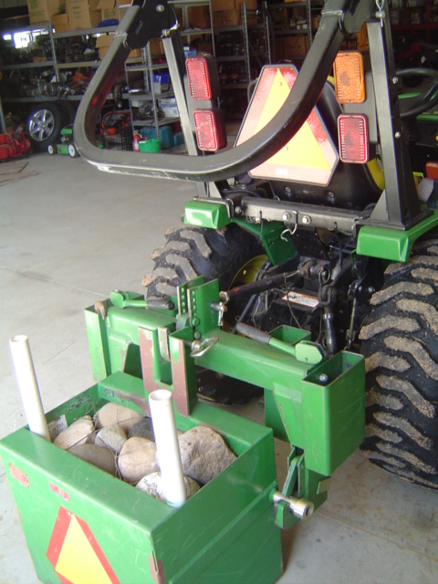

One thing that I'd recommend and did on both the 4010 and 2025R is move those ROPS lights to inside the ROPS. If you operate around any tree limbs or brush at all or maybe even an occasional protruding something off a post or gate, you'll bust one of those. Replacements aren't cheap. Just disconnect the wire connectors, move the lights and reconnect on the other side. An easy job that'll save you a bunch of bucks.

Noticed it geared, not a hydro.. let us know how you like doing FEL work with it. I thought about going with gears but because snow blowing a lot was in the task list decided the hydro pedal would be appreciated.

As Ralph said, if you work around trees and branches moving the lights on the ROPS inboard will help prevent lens breaks. And as you can see by the pic, replacement red lenses are cheaper than yellow......
