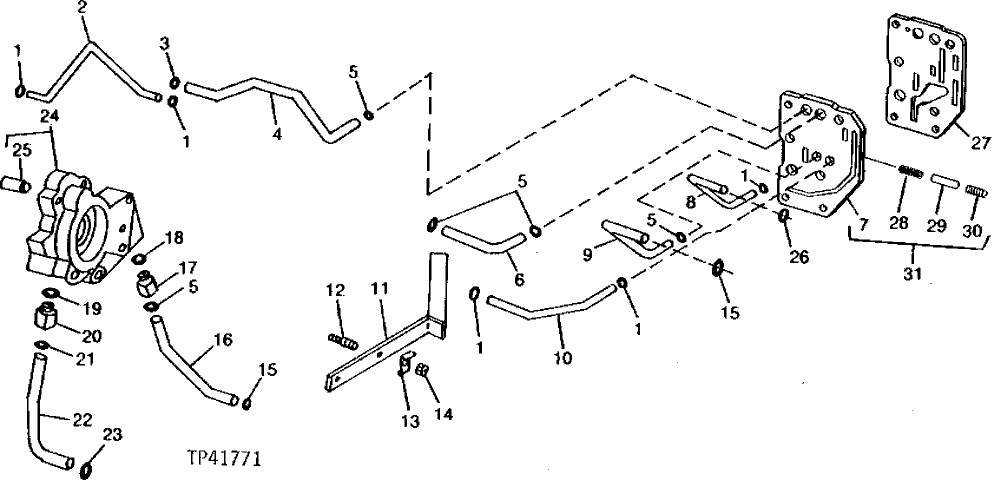

Have a 410 in my shop, was brought to me last week owner said clutch was slipping, I did question him as to if he was sure it was the clutch and not the reverser that might be the problem. The man is a know it all and just wanted us to split it and put a clutch in it!!!! Well we did that and yes the clutch and pressure plate did have some ware and it did look as f it had been slipping a bit. Long story short we put it back together and it is still slipping forward and reverse, to the point it will almost not pull itself. We checked psi at control valve 150 psi at the test port when floor shifts are in gear and reverser is in N, as soon as you shift forward or reverse psi drops to 0 and in 2-3 seconds will climb to 40ish. I believe we are gong to have to pull the reverser and rebuild both forward and reverse packs? I have "know it all" humbled now and want to make sure I am diagnosing the problem correctly anyone with hands on experience with this tractor?
   / JD 410 tlb reverser trouble #2
Yes sounds as if reverser or supply tubes are leaking. Due to the fact I was employed by an "Ag only" JD dealership my ind tractor knowledge is limited.
