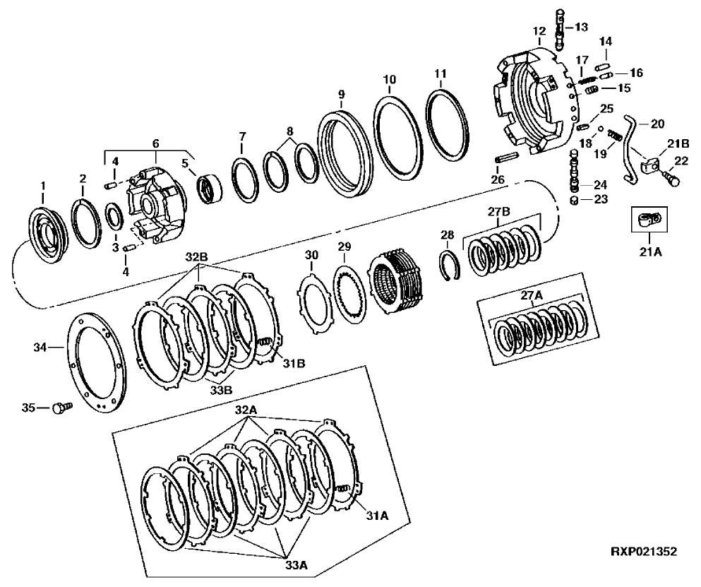

My JD 4030 diesel with Quad Range (2x8) does not smoke and the engine runs good. The hydraulics work good....front end loader, Rockshaft and 3 pt. hitch, steering and brakes. There are no hydraulic leaks and oil and hydraulic fluids are ok. It maintains good RPM whether driving, pulling or using the PTO for baling or brush hogging. In other words, the engine does not slow down under load. However, after running and operating for a short while, the tractor starts moving slower...especially while moving up an incline. It will get to a point where, in order to get the tractor on up the incline, I have to go into granny gear. Even after a while when operating on level ground it begins to start creeping. It seems like there is either some kind of slippage within the power train system or the brakes are on. The manual states in diagnosing problems of this nature that slippage in all 4 speed gears could be caused by "Plug leaking or missing from brake housing". I'm not sure where to find the plug is located in the brake housing or even how to get to the brake housing. I would sure appreciate some suggestions on this problem I am having.
   / JD 4030 - Creeping slo-mo #2

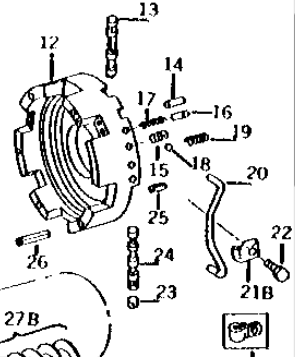

Quad-range trans has a hyd hi-lo. Does tractor slow down in both speeds of this hyd hi-lo? There's 2 possibilities either the traction clutch is slipping or the hi-lo clutches are slipping. I suggest to check clutch pressure on clutch valve on LH side of tractor. Pressure should be 155-165 psi. I have no idea what "plug leaking" you're referring to and I was a JD dealer service manager back in 70's-80's. There was a clamp(parts key 21A) on a line on the hi-lo housing that could break letting line slip out loosing either high or low speed.

21A ?? I don't see it, just sayin... ;)

Sorry I posted incorrect photo the 1st time.

I think plug the TM is referring would be on the hi-lo housing. One would have to split tractor to observe it's presence or absence. Have you checked to be sure hyd filter relief valve is seating? Have you checked clutch pressure?

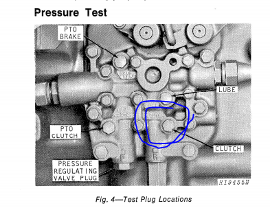

I have not checked the clutch pressure....am having a pressure line/gauge fabricated to do this at our local hardware store....will get back with you on this after I get a pressure test.
As to your suggestion about checking the hyd filter relief valve seating correctly....is this on the outside of the tractor (left,driver side on the tranny case)? Is this the same as the "pressure regulating Valve plug" indicated in Fig. 4 on the page that I sent you as an attachment?

Yes you're correct

Hello Tx Jim,
The pressure gauge tested zero, which I find hard to understand/believe....after all, I CAN drive the tractor and shift gears and it operates in all 16 forward speeds and operates in reverse....so something must either be wrong with the gauge or I have plugged into the wrong hole (which I don't think is the case). Anyway, here is something else to consider.. My hydraulic fluid is dirty brown...not black, but sort of coffee brown. I am going to change the fluid and put on a new filter today, and then see what happens.
Also, this hi-lo oil tube you told me about that may be loose ....isn't that located on the Two-speed planetary Assembly/Brake Housing? In order to get to this don't I have to do a separation? If changing the hydraulic fluid/filter doesn't fix my problem, more and more it seems like I am going to have to do a separation. With a Soundguard cab removal this is beginning to look like a major, major repair job.

I heard of checking/replacing hi-lo tube clamp by removing clutch valve housing. SGB(cab) doesn't require removal to split tractor between engine & clutch housing. While trans oil is drained check/clean trans oil sump screen.
