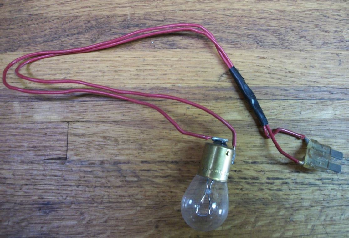

Look for the short..
I cobble up a 12v lightbulb on a blown fuse that I can plug into the fuse slot.. the light is on when there is a short.
This allows you to poke around, moving wires, and unplugging connections to trace back where the short is located.
   / JD 3720 BLOWER FAN TROUBLE SHOOTING #3
The same fuse also operates the compressor clutch. You will want to check that also.
