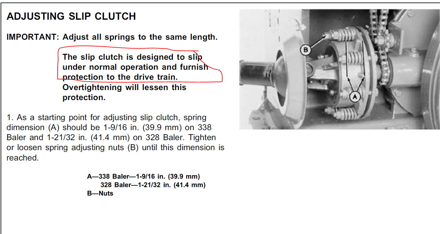

I have never had the clutch slip unless something went wrong. As mentioned having it chirp each stroke will wear it out in no time.
Please read this slip clutch information copied from JD sq baler operators manual. I stand by my statement that a correctly adjusted,non stuck sq baler slip clutch should chirp with each plunger head stroke. I was taught this info when I attended JD service school.

   / JD 336 square baler sheer pin #7
A slip clutch that is set too tight will cause premature wear on the driveline and ultimately failure. It will also cause failure of the pto in the tractor. Having run balers for 45 years i consistently run the clutch even looser than the factory recommends. It is far cheaper and easier to rebuild the slip clutch than any of the other mentioned parts.

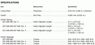

   / JD 336 square baler sheer pin #9
Official John Deere baler specs for slip clutch torque on a 336 is 400 - 500 ft-lbs. Meaured with a 10 foot long pole and a spring scale with a wood block between the knives.
There's a typo in this chart: the "366" is actually "336" as is repeated in a later section of the manual.
