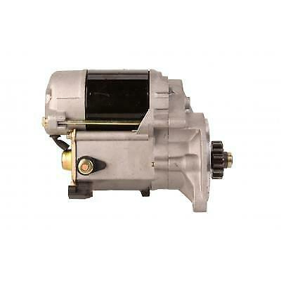

It is a hydrostatic transmission. I have seen this diagram but searched the entire transmission area and cannot orient this picture to the tractor. Is the center case shown in this diagram visible without dismantling other structures?
   / JD 3320 suddenly will not move. Throws an error code 14. Solonoid coil insufficient. Bought a new coil but can’t find where the solonoid is located! #8
Is your starter like this, if so is not the solenoid in the bottom of the starter

A shop manual would be a wise investment.
   / JD 3320 suddenly will not move. Throws an error code 14. Solonoid coil insufficient. Bought a new coil but can’t find where the solonoid is located! #10
Make sure a stick or something didn't get jammed into the pedal assembly under the tractor.
