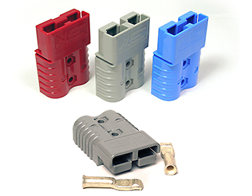

You can get these down to a 10G wire size. Double duty of what you would need.
Anderson Powerpoles
