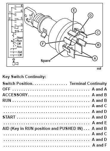

Does anyone have a schematic for the ignition? I'm not sure if I hooked the new one up correctly. It starts but the glow plug light doesn't come on. Does that mean the plugs aren't working? The dealer told me they sent the right ignition, but there isn't a glow plug position on the new switch like there was on the old one.

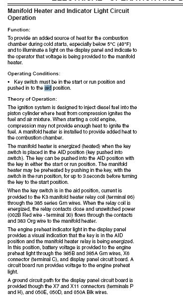

B-Run Position - With the key in the run position, and the engine not running, the engine oil pressure light should flash and the battery charging light should illuminate. Both lights should turn off when the engine is running. You will also hear a clicking noise when the engine fuel shut-off solenoid engages. With the key in the run position, push the key in to activate the air intake heater system.

It seems to be running just fine beenthere. The old switch wasn't the one that's supposed to be on it, and the new one is from the dealer. I had an extra wire so I plugged it to the aid slot. I think that fixed the problem. I just took all the old wires off one at a time and put them on the new switch. Seems ok, I was just hoping somone had a schematic of what wires go where on the back of the ignition so I could check myself. I guess I need to pony up and get a manual, not sure where my Dad put the one that came with it.

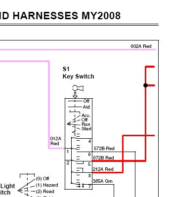

One is for pre 08, the other for 08.

I thought I would be able to understand a diagram, I was wrong! Did I plug the green wire into the correct place? Well, I guess I should just ask where I should plug the green wire. Thanks for everyone's help!

I went threw every schematic and never found a wire connected to "aid". Perhaps this will help.
