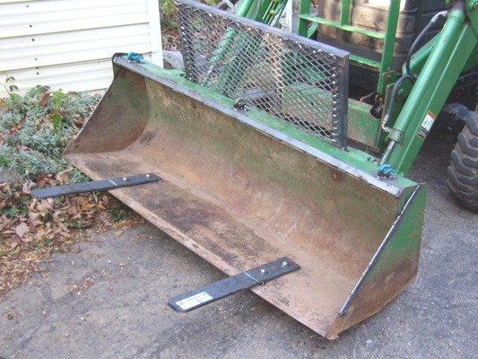

I have seen other tractors woth hood damage from rocks/stuff that came back off the bucket. One was repaired with pop rivets and an aluminum backing strip inside. Didn't6 look bad.:D
Picture of a rock catcher on my bucket.
