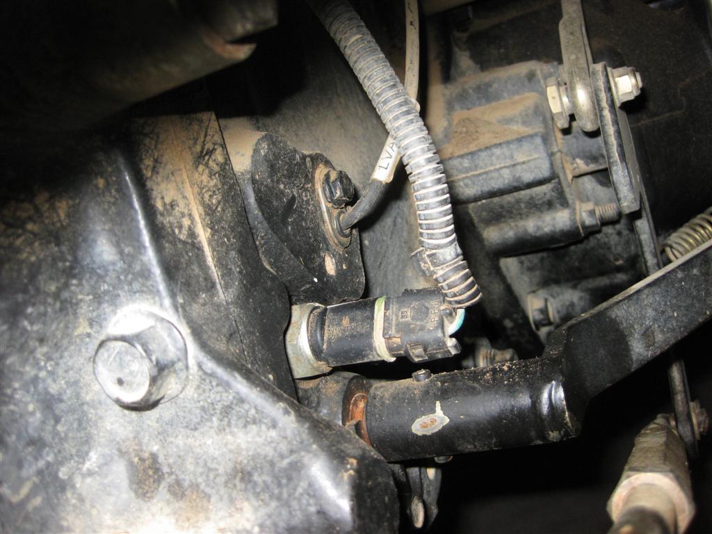

Folks,
This just started flashing on the display. So far it doesn't seem to affect the tractor other than the speedometer and cruise control are not working correctly. I've read the owners manual so I understand what Error 06 relates too.
My question is has anyone else had this happen and how much did it cost you for the dealer to repair it /
   / JD 3320 Error Code 06 #2
My 4720 did that a couple of years ago and it was the MFWD sensor, it is located on the left side under the seat if you are in driving position. I thought I had a picture but I am having trouble finding it, but if you replace it hydraulic fluid will be above the sensor so park tractor so it leans away and do it quickly.
   / JD 3320 Error Code 06 #3
Here is a picture of the MFWD sensor, it is the one held in by a bolt.

Happy ending ! I purchased a new MFWD sensor for $80.00. 10 minutes to change out the old one and no more erro code 06 and the cruise control is working as it should be. Now I can repurpose the other $400 for something like a new pistol.....
