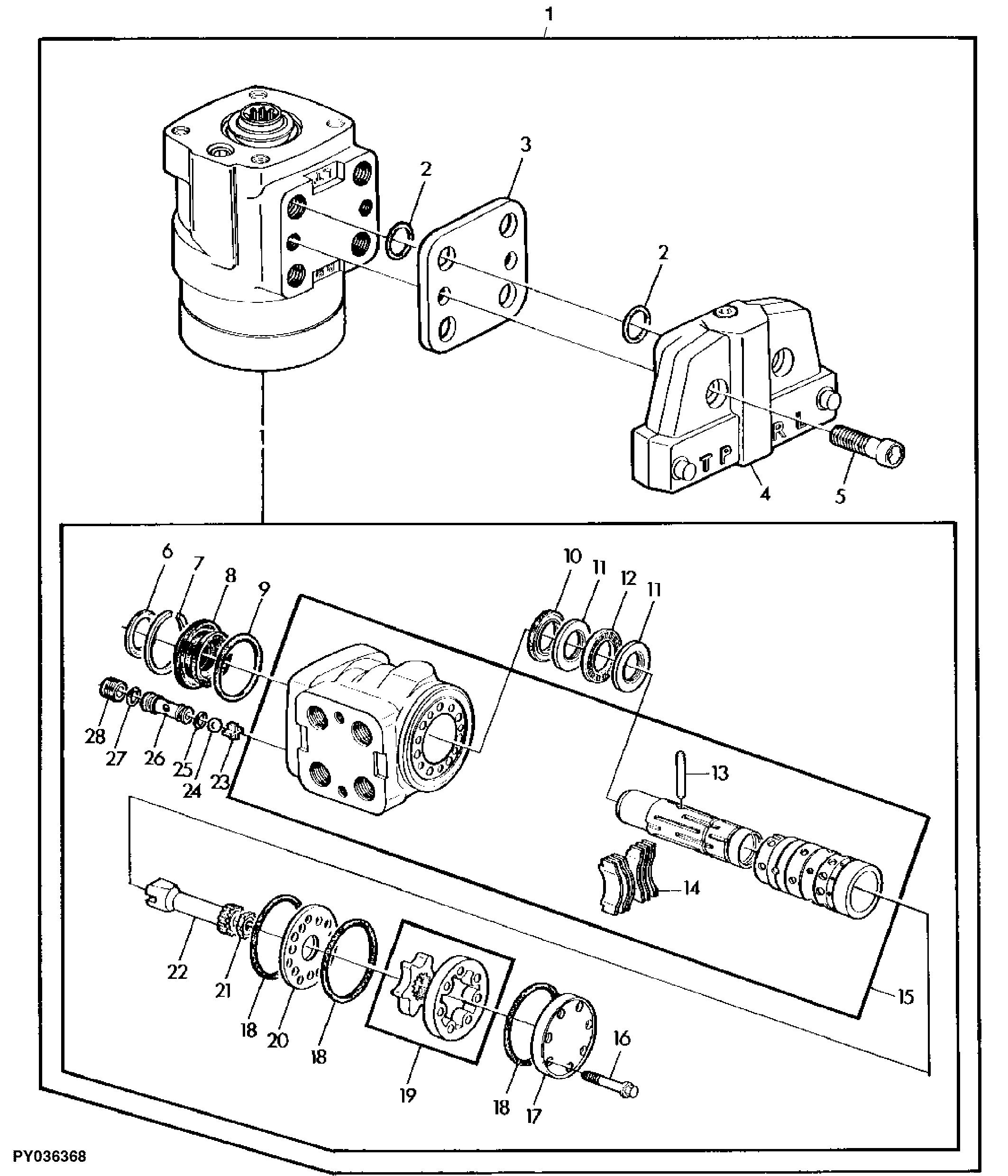

Hey Everyone,
Obviously its planting season which is why all of these problems come out of the woods all at once...
The problem is that I constantly have to keep turning the steering wheel slowly to the right (clockwise) in order for the tractor to keep going straight. If I don't, it swings left and its very hard to get straight rows for planting with a drunken tractor. Anyone heard of this before?
The steering cylinder (hydraulic) has been rebuilt a few hours ago, but was last fall. I don't remember either way if it did it before I rebuilt the cylinder or not. Not sure if it has anything to do with it.
Any pointers?
M
   / JD 3140 Steering Issue #2
Steering wander is one of the hazards of hydrostatic steering such as the 3140 has. Seat(parts key #26) may be leaking internally.
