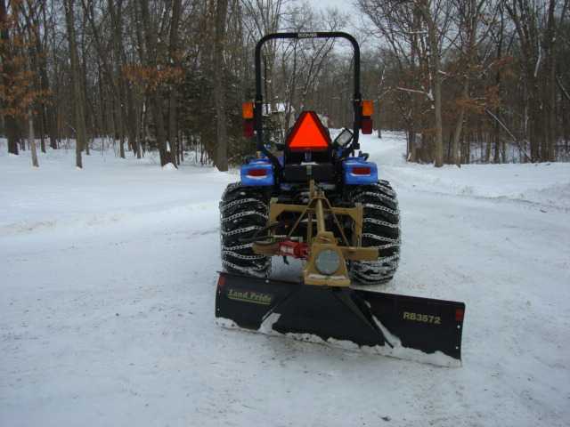

I second the vote for the 6' blade and as many rear remotes as you can afford. I would also recommend that you consider a Quick Hitch.
I use a Landpride RB3572 rear blade on my 33hp New Holland. I definately wouldn't want anything smaller.
