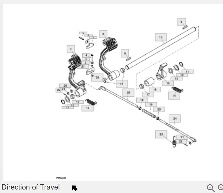

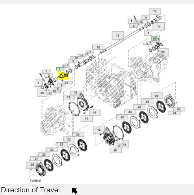

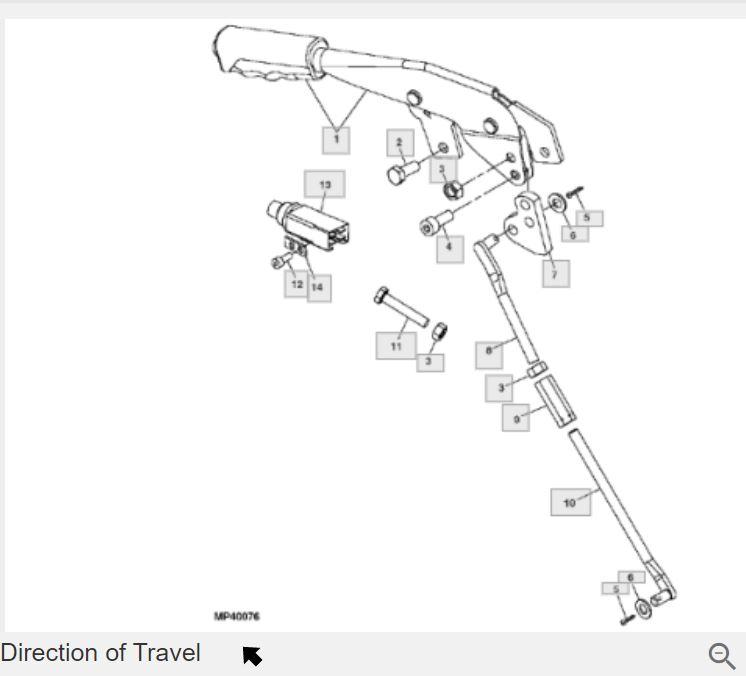

Thanks for volunteering, my daughter loves horses. I might not be of much help, but here goes:
Drawings are from JD parts.
I am guessing the park linkage hooks to the arm, key 7, highlighted in yellow. Brake pedal linkages, (guessing again), connect to arms, key 5 & 15.
Good luck with the repair! (y)🤠

Thanks Zebrafive! The diagrams help a lot. Can you share your source? I have a CD version of the service manual coming. Hopefully that will help. The tractor operators are using the bucket on the ground as a parking brake now. It seems unsafe to me.

www.jdparts.com If you sign up with a dealer you will get prices of parts at that dealer and the ability to order for dealership pickup.

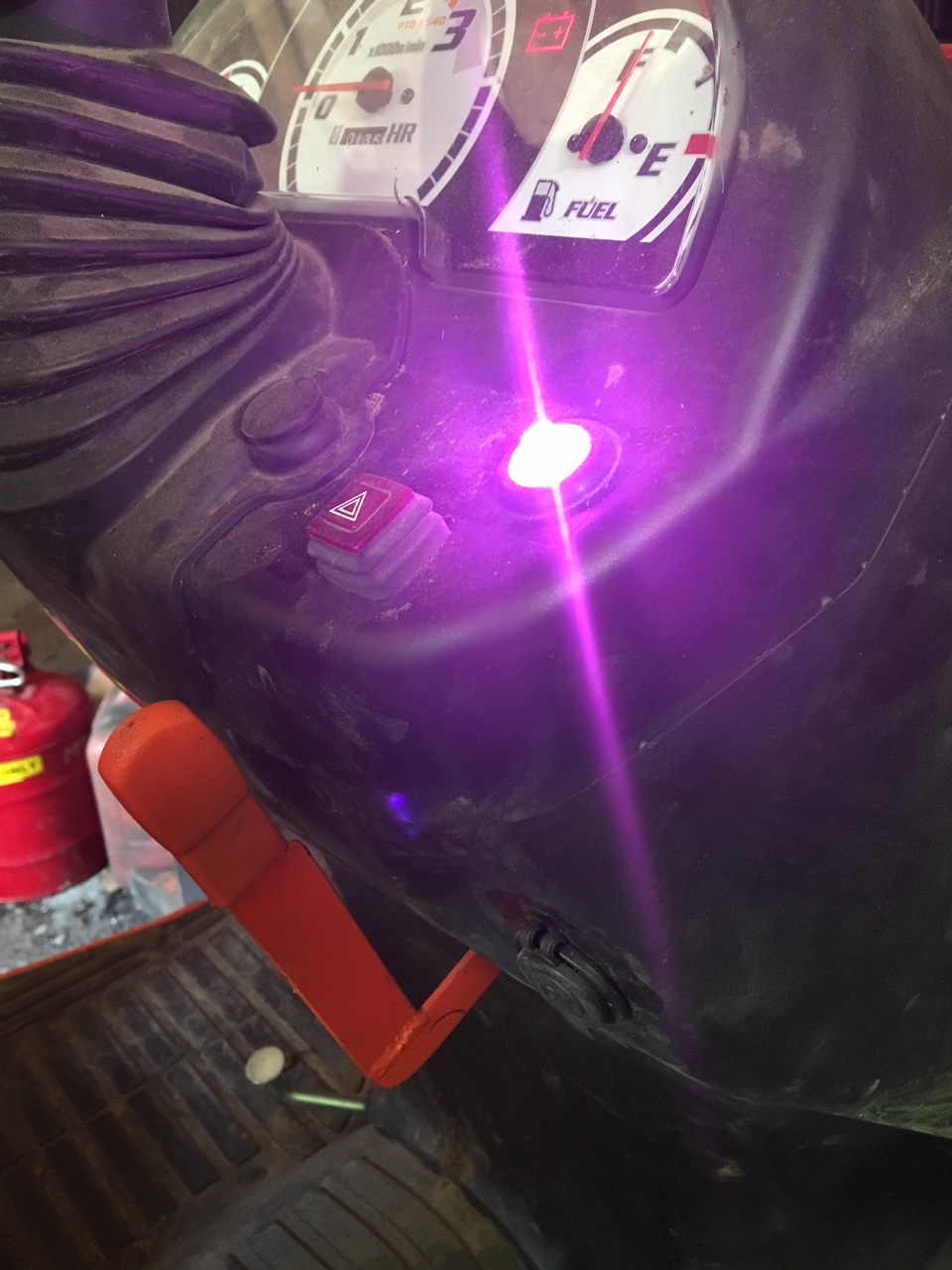

The Kubota B26 we have has several operators and operating with the parking brake on was a problem. Fixed by extending the parking brake handle and adding a parking brake on light.
Much more ergonomic intuitive.
