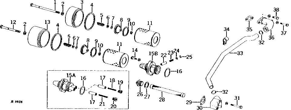

I have a 3020 jd wide ft end gas model how many hydraulic filters does it have and where are they located at.
   / jd 3020 location of my hydraulic filters #2
Number of hyd filters depends on type of trans. QR trans has one & PS trans has two. JD offers filters for a very competitive price. AR75603 Filter Element - ELEMENT,OIL FILTER ADD 8.03 USD Photo below is for PS trans. Be sure and check/clean sump screen(parts key 28). Filters & screen are located on LH side of tractor under battery box

Info is in the operator's manual and in the free parts book on the JD web site. 1-800-522-7448 of somebody went and lost the manual.
