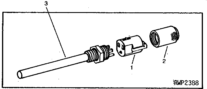

I have a 65 jd 3020 gas that can be a bit of a bear to start and was wanting opinions on what block heater I should look into ? thinking bout circulating canister heater in bottom radiator hose.....Needs to fit my very tight limited budget and not wanting to spend all day on an install.....thank you for your time and know how.......did get the rear wheels moved after 49 yrs of never being adjusted now that stubborn lift arm still wont budge.....

is it true that there is no freeze plug in these?
   / jd 3020 gas COLD WEATHER START OPTIONS? #3
No freeze plugs. You can utilize a tank,hose or oil pan heater similar to photo but no block(freeze plug) type.
