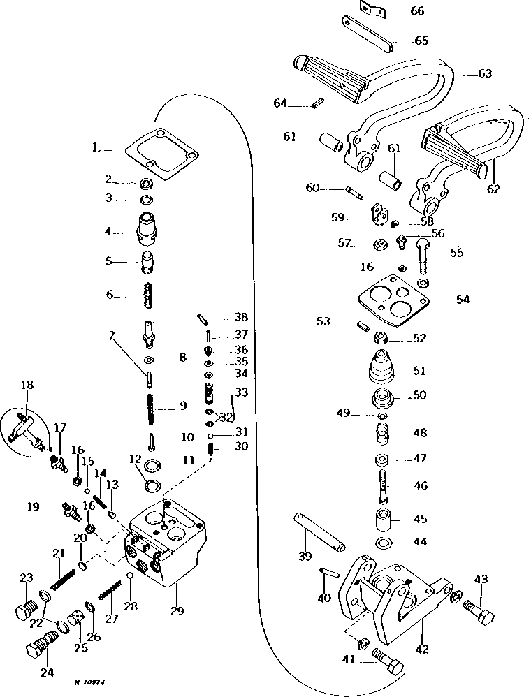

John Deere 3010 Gas
I backed up, stepped on the brakes, and they worked, but will not release. Tried going forward and backwards but they still will not release. Anyone have any familiar problems/solutions?

Do you have a service manual?
May need to trace the hyd. lines from the brake valve to the disk brakes to determine where the problem is at.

Does the service manual troubleshoot the brakes? Must be some place to check hyd. pressure and to determine what backs off the brake pads (spring or hyd. pressure? ).

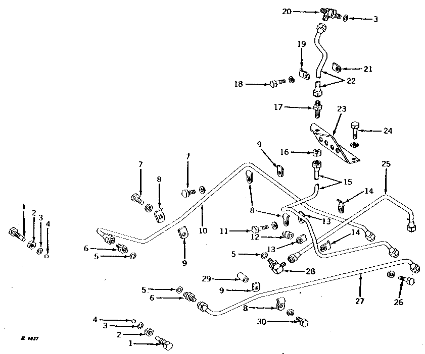

There are bleed screws(parts key #1) on axle housings that can be loosened to free brakes. You could also check the screen(parts key #25) in brake housing for plugging.
